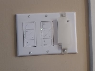

The goal of this ible is to show you how to make a 3D printed light switch guard so that you can't accidentally flip a switch. This is useful in home automation scenarios with smart bulbs, retrofitted circuits (I had a light switch for my garage that now powers my garage door opener), and more.

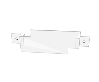

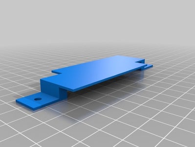

Lastly, you can use the files with the design I made. The STL file is ready to use for printing, and I included my SKP file if you want to edit it in sketchup.
Step 2: Print and Clean
Print it in the orientation it is in now, using added supports. Whenever I make screw holes in my models, I always clean them up after the print by using a drill bit of the size needed, but spinning in reverse, this means that the heat just smooths out the hole, preventing snags and tears.

The cut-out corners mean that you can still flip the switch if you need to, but there will be no more accidental knocking of the switch.
