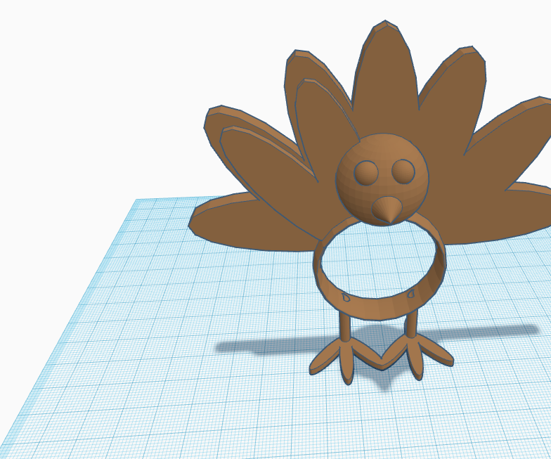

Step 5: Make a Custom Top
To make any custom top for our ring, we first need to start with yet another ring! If we recall back to Step 2, the OD (outer diameter) of our battery holder is 26mm.
Make a hole cylinder 26mm in diameter and at least 7mm thick. Create an outer ring cylinder of 30mm and the same thickness. Align and group these shapes together.
This is your connector for any custom top you want to design for your ring! We want a tight fit that can be pushed on to the ring for whatever design is on top. Make a few copies of this part for future designs!
Make a design using the basic shapes and add onto the connector. Make sure you cut a hole for your LED in the middle of your design. I've cut out a 7mm hole for my 5mm LED just in case my LED isn't perfectly in the center of my ring after assembly.
