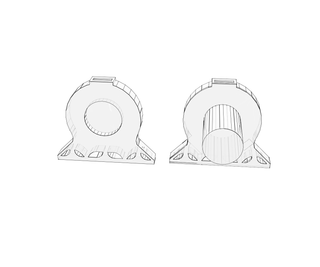

Step 1: Printing the Files

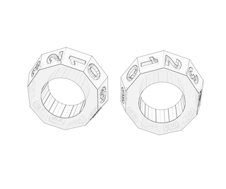

The first step would be to print the included files. I put the sides and dials separate so if you wanted to print them in different colors it would be easier to do so. I decided to have my sides printed in black and my dials in red.
Update: I had my sides printed and I did not account for enough space between the peg and the holes. I have updated the .stl file for the sides so that there should be plenty of space for the dials to rotate and the sides to be glued together.
Step 2: Assembly
Assembly is as easy as fitting a round peg into a round hole. Just put the dials onto the peg as shown in the above pictures. with the printer that I used it had enough movement and error that some sanding was needed to make the peg diameter smaller. this added a little extra time, but it doesnt effect its looks or it functionality in the endd. Once the dials are on just put a small amount of glue or epoxy into the indent of the left side where the peg goes into. You want just enough glue that when put together none of it will get onto the dials. If any of it does the dial will not move.
