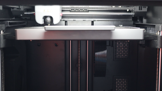

Step 1: 3D Print
The first step is to 3D print all of the parts. The STLs can be found here: https://makerworld.com/en/models/1004102. No supports are needed if you orient the parts correctly on the print bed. I used PLA because that is what I always use, but if you have another material that you know how to use, it should work as well. (Just not TPU.)

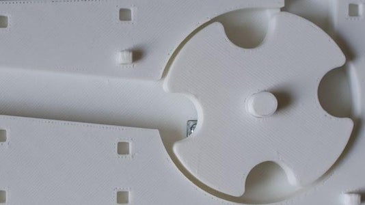

Step 3: Add Axles to Wheel
Put each axle in one of the holes on the wheel. Either axles can go into either hole. I would recommend attaching the axles with a little super glue because after the motor turns for a while, the plastic can start to ware off, loosening the fit.

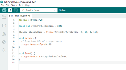

Step 7: Upload Code
Upload the code to your Arduino. If the balls enter to quickly, lower the RPM in the code and reupload. If the balls exit to slowly, raise the RPM in the code and reupload. You want the ball to exit at the same exact time as the next ball enters. I currently have the RPM set at 15 which is what worked the best for me. This number might change slightly for you based on factors like the weight of your ball and torque of your motor.
Code:
#include <Stepper.h>
const int stepsPerRevolution = 2048;
Stepper stepperName = Stepper(stepsPerRevolution, 8, 10, 9, 11);
void setup() {
// Fine tune RPM of stepper motor
stepperName.setSpeed(13);
void loop() {
stepperName.step(stepsPerRevolution);
