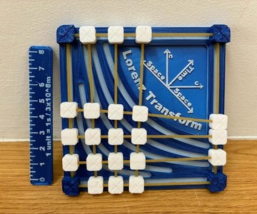

Everything printed well but the accuracy of the 3D printed joints was off. I changed a few parameters but either the hole was too big creating a sloppy loose fit, or the hole was too small and the shaft wouldn't slide freely. I had already printed a whole bunch of test parts when I realized that the shaft would always slip through one side but jam up on the exit of the hole. There must be some printing defect there and I suspected it to be the seam. Sure enough when I looked at the slicer preview, I saw the seams being exactly the places where the joint had trouble sliding through. Now I knew the problem but Cura (the slicer I was using) doesn't support paint on seams and their seam placement was just too grainy. In the end I carved little notches into the print to encourage the seam to naturally form there when the seam settings were set to "sharpest corner" and "expose seam".
Step 12: Assembly
The assembly is actually quite straightforward and involves few steps
Download the free stl files here : https://www.printables.com/model/1444013-lorenz-transform-simulator
  1. First, print out the base once, the small joints with pins 19 times and the ones without the pins for the tracks 2 times
  2. Next, cut down the spaghetti noodles to around 12cm. Make 10 of those
  3. Now place 3 joints with pins into each track on the outside and fasten them in place using the pre-cut spaghetti
  4. After that lay out the inner grid of joints (see picture) to form a 3 by 3 grid
  5. Once that is done slide the rest of the rods onto the joints and glue the rods in place only with the joints on the outside
  6. Finally lubricate the tracks for better performance
Step 13: Testing
This updated design is so much better and although it does jam up once in a while it now only takes around 5 seconds to do a Lorentz transform instead of a full minute. Overall I'm happy with this final result
