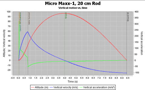

I came up with a design that would be 11 cm in length, weigh under 4 grams and, in theory, fly to a height of 97 m

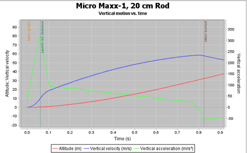

I ran simulations for both type 1 and type 2 motors on the same rocket, and although the type 2 packs double the power it does not deliver a higher altitude. The type 2 motor has got a much higher initial acceleration but this also causes the rocket to experience a lot more areodynamic drag effectively cancelling out the extra power this motor has. In our case, the type 1 motor will work best.

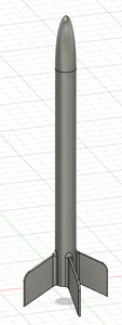

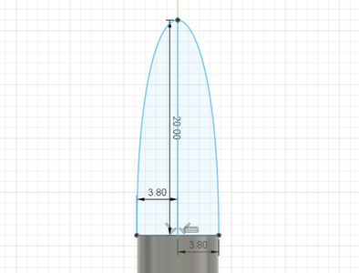

In fusion 360, I started off with a 7.6mm (6 inside + 2*0.8 wall thickness) cylinder and a length of 80 mm for the main body. The nose cone is made using the spline tool and then using the revolve tool on the sketch and the y-axis. The nose cone has a length of 20 mm and a radius of 3.8mm.

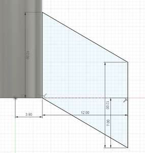

The circular pattern tool can be used to make 4 identical fins from its sketch and then finished up using the fillet tools.
Finally, the shell tool is used to make the rocket hollow with a wall thickness of 0.8mm. A bulkhead can be added at 16 mm from the bottom up for the micro motor to push on.

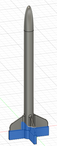

The STL files for the rocket and the support can be found in the attachments.
Step 3: Printing
The 3d printing is pretty straightforward, load the two stl files into your slicer. Set the infill to 100% and 0.2 mm layer height. Also make sure to select print as support for the second support object.
