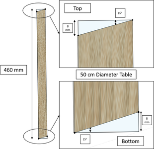

Step 5: Preparing the Wooden Legs
After assembling the 3D printed parts, it is time to prepare the wooden pieces that will make up the legs for the side tables.
To make the side tables' legs, I used two Saligna wood strips planed-all-round (PAR) with a dimension of 20 x 30 x 1800 mm. The wood strips were then marked and cut to specific lengths for the legs (Please see attached images). You can use any wood when making your side tables; however, the most critical dimension is the thickness (20 mm) of the wood strips. This will determine whether the wood will be flush with the 3D printed Supports when fixed together. The following is a list of the number of wood strips and dimensions needed for making the legs.
Materials: 50cm Diameter Table
  1. Wooden Legs – 20 x 30 x 460 mm X 3 (Use One 1800 x 20 x 30 mm strip length)
Materials: 40cm Diameter Table
  1. Wooden Legs – 20 x 30 x 450 mm X 3 (Use One 1800 x 20 x 30 mm strip length)
Cutting the edges of the Wooden Strips
After cutting the wood strip into the dimensions mentioned above, each leg edge (top and bottom) will need to be cut at a 15-degree angle. This helps with creating a flush connection and helps the table stand flat. Please see the attached Fusion 360 dimensioned images detailing the required dimensions to cut off.
