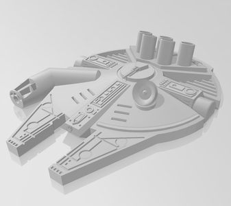

Step 3: Adding Rear Storage Features: Pen Holders, MicroSD Slots, and USB Stick Mounts
With the base model ready, it was time to transform the rear section of the Millennium Falcon into a multifunctional storage area.
I began by creating five cylindrical holders for pens, pencils, or markers. Each holder was made by combining a solid cylinder with a slightly smaller “hole” cylinder, which was subtracted to create a perfect hollow. From my testing, 2 cm of depth provides enough support to keep items upright.
Next, I modeled two microSD card slots using rectangular “hole” shapes, sized precisely for a snug fit. To make card removal easier, I added a small half-sphere cutout at the bottom edge of each slot — this little indentation gives your finger or nail the space needed to push or pull the card effortlessly.
Finally, I incorporated two USB stick mounts. These were designed as rectangular “hole” shapes matching the dimensions of a standard USB-A connector, so that a flash drive can “click” into place as if plugged into a port. This friction-fit design keeps the drives secure while still making them easy to remove.
By combining these three features — pen holders, microSD slots, and USB mounts — the entire rear section now serves as a compact, versatile storage hub.

Step 5: Adding Front MicroSD Card Slots
The front section of the Millennium Falcon organizer features six microSD card slots, arranged in two rows of three on either side.
Each slot was created using a rectangular “hole” shape, sized precisely to fit a standard microSD card snugly.
This symmetrical layout not only maximizes storage capacity but also keeps the front section visually balanced and organized.
With this addition, both the front and rear of the organizer now provide dedicated spaces for memory cards, pens, and USB sticks, turning the Millennium Falcon into a fully functional desk companion.
