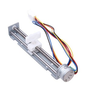

Step 3: DVD Drive Stepper Motor Disassembly
First of all we must open the 2 DVD scrap to extract the motors and moving parts necessary for the CNC machine. We must open them carefully so as not to the break the pieces we need. In the following image we can see Image. Simply by unscrewing the 4 screws marked in the image we can extract the part which we need, a whole shaft together with a stepper motor.
Step 4: Attach Motor With Base
We have soldered the wire with stepper motor and then given it a spacer with a piece of wood. (As shown in the picture below) we cut a wooden plate that will be our base.
