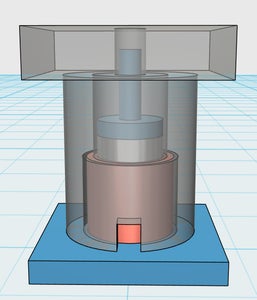

This mini actuator stands just 9.2mm tall and could be used as a source of haptic feedback in a variety of devices. I developed it while working on a project to aid those with visual impairment. I wanted to see if I could create a more localized haptic feedback source, unlike vibration motors, while still keeping the over all size as small as possible

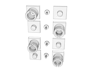

Step 2: 3D Printed Parts
All Parts where printed in ABS plastic on an UP Box printer using it's highest resolution
This actuator consists of three 3D printed parts
1. The Base
2. The Pin
3. The Enclosure
The files are available below
The Base is where the coil will sit, the Pin is attached to the magnets and the enclosure keeps everything together.
When a voltage is applied to the coil one way, it will repel the magnets which will push the pin upwards through the hole in the enclosure. When the voltage is reversed the magnets and pin are pulled back down inside the enclosure.

Putting this actuator together is a bit fiddly due to the small size of the parts, tweezers are recommended.
1. Add a few drops of Super glue (I used Araldite) around the sides of the cylinder on the base component.
2. With the tweezers drop the coil over the top of the cylinder on the base, make sure wires of the coil are clear.
3. Using the glue again, attach the magnets to the base of the pin, making sure it is as closely aliened as possible.
4. WAIT until the glue has FULLY dried before the next step!
5. Drop the pin and magnets into the enclosure and wiggle the magnets around until the pin falls into the small hole in the top of the enclosure.
6. Glue the enclosure onto the base, making use of the little notch in the bottom of the enclosure for the coil's wires.
