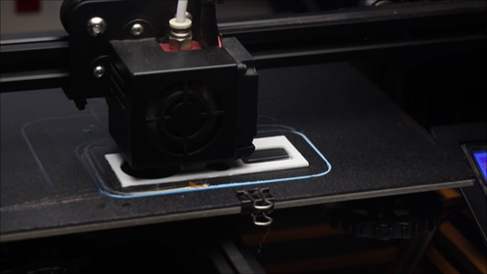

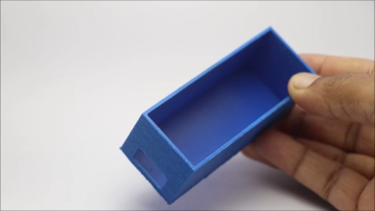

The main part of this project was the design, Since i had many models in my mind i wanted a design that is small yet looks appealing with all the comforts of a real console.
I came up the most space saving design which was rectangular in this case and to design this i used the TINKERCAD
application, if you need the original files of mine you can just ask in the comments and i will be happy to give you.

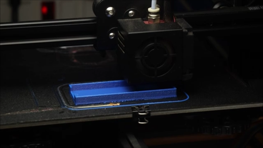

After i made the design considering the size of standard components i exported the model to cura slicer
There is no need of any rafts or supports at the time of printing and you can follow the same set of placements like i did, there are 2 parts in total and the printing time is usually not longer since the parts are small.
Choice of color is left to you, in my case i will be using black filament to print the base and the white one to print the top part.
After the parts are printed there is no need of any post processing since there is no supports, Now you have the frame for this console, Now we will build the circuit and let's see how.

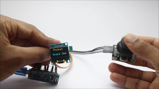

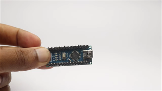

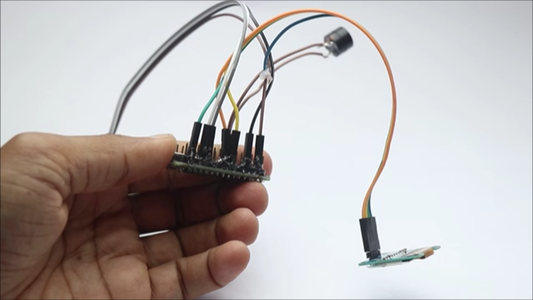

The circuit is simple and easy to be able to follow for a newbie also, I will still explain the circuit to make it very simpler for all of them.
The project uses joystick module, buzzer and OLED module other than arduino nano

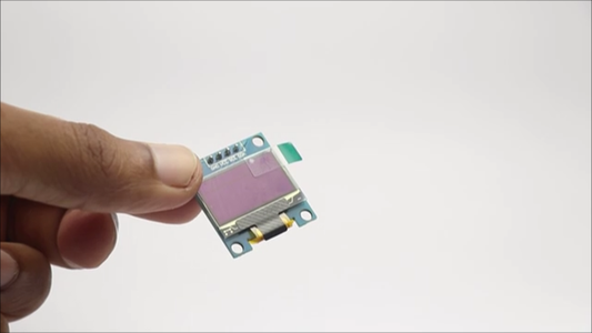

The OLED module has 4 pins, Scl, Sda, Vcc and Gnd
Scl and Sda pins are connected to A4 and A5 in the nano, whereas the vcc and gnd to 5v and gnd pins of the nano

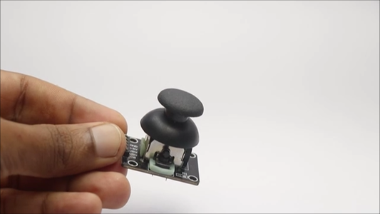

The Joystick module has 5 pins out of which we will be using 4 of them in this project
The Vrx and Vry is connected to A0 and A1 pins of the nano whereas the vcc and Gnd to 5v and gnd pins

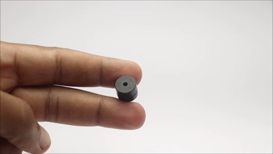

Buzzer has 2 pins and you can connect gnd to gnd and the positive of buzzer to D2 pin on the nano
Now since the circuit is ready we can connect the nano board to computer via programming cable and upload arduino program, you can use the program given below
You can customise the display messages that you want to see on OLED, if you think this is cool you can simply head over and use my program.
Select the type of board and the port number and click on upload button, After the uploading is complete we can test the circuit for its working.
Simply press any button on the joystick module and you should see the game running on OLED module.

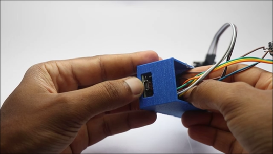

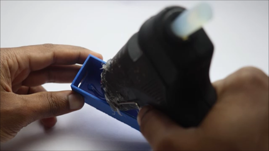

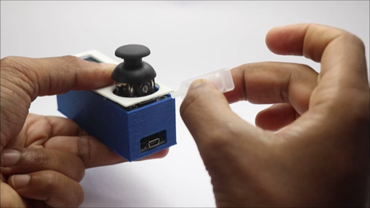

I will start by gluing the nano board to the base of the 3d printed base frame, you can use double sided adhesive for this purpose but in my case mild hot hotglue did the job very well.
You have to make a note here that the USB point should face the hole and does not interfere with cables.

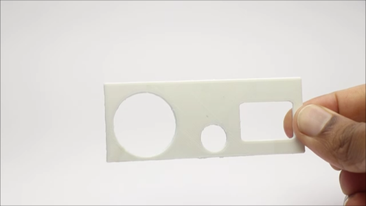

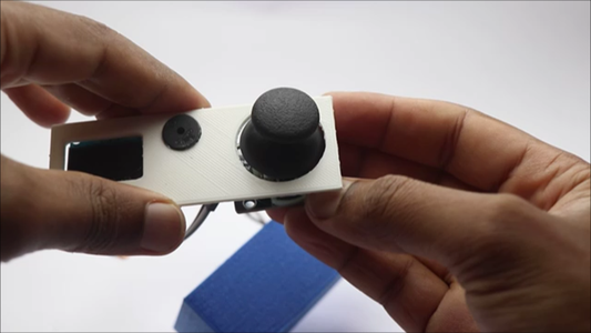

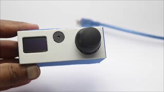

After this is complete we can work on the top cover part, here in the top cover we have slots that will hold the OLED and the joystick module.
Even here also i will use some amount of hot glue to stick to the top frame, allow to dry completely and handle with care since if you pull the wires too hard it may create break in the connections.

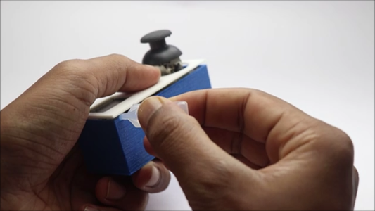

Now attach the top and bottom frame using superglue, i recommend using only this because using hot glue will cause a additional layer that will create space.
Use small amount of glue and press the 2 parts together for some time and now you will see that the frame is ready and the console is ready for using.

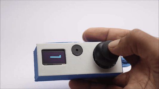

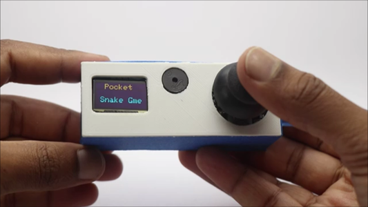

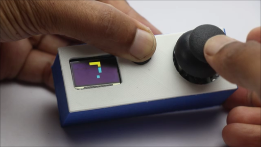

Connect the USB cable to power bank and the other end to arduino board power point, and now you should see the display on OLED showing the snake game message
To begin the game you can press any button on the joystick module, now when the game starts like the usual game you can use the joystick module buttons to navigate the snake on screen and make it eat all the food on the display.
When you eat it the snake eventually becomes bigger and bigger and now the challenge arises to keep the snake body touching from itself, if it touches then the game is over with a beep sound.
Also when you make the snake eat the food the buzzer makes a small beep sound, you can see the full gameplay of this project in the working video below.
