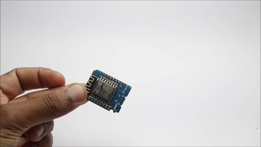

Uses wifi technology that is built on board on an wemos board to fetch the latest updates of weather and everything is real time.

Wemos D1 Mini

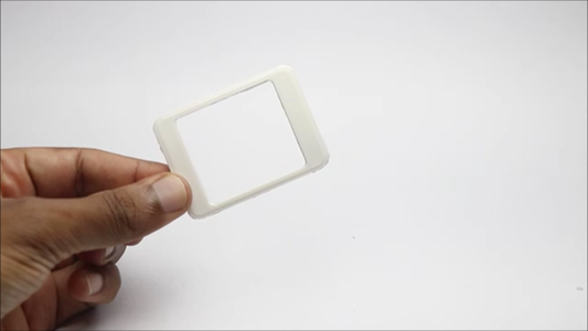

The design for this weather station was very simple since the base and top frame was designed considering the standard size of the components.
Both of the parts that i call it here as the top and the base frame were designed using tinkercad application and later exported to cura slicer.
The files were then exported to a 3d printer, i will be using black and white PLA filament to print the parts and the overall print time for me was less than 50 minutes considering both the parts.
No need of using rafts or supports at the time of printing since there is no overhang in the model, make sure you are using the exact same placement of the model like i did to get the best results.
Now after printing if you need to clean any basic things you can do it but it is not necessary.
This will complete the frame part for the weather station, if you don't have a 3d printer you can recreate the same model using the dimensions used for this design on a piece of cardboard and use glue to reinforce the frame and later use it.

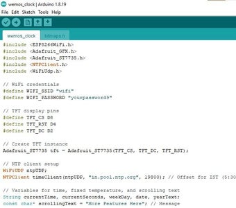

To begin with i will by uploading the code to wemos board, the process is very simple
connect board to computer using USB cable, open arduino ide and paste the below code.
If you are using arduini ide for first time you may need to install few libraries, do it and simply select proper type of board and com port and click on the upload button and later we can head over to building the circuit like given below
ST7735 TFT display connections with Wemos D1 Mini
VCC to 3.3V and GND with GND
CS from display to D8 on wemos board
RST to D4
DC to D2
SDA (MOSI) is connect to D7 pin
SCK (Clock) to D5

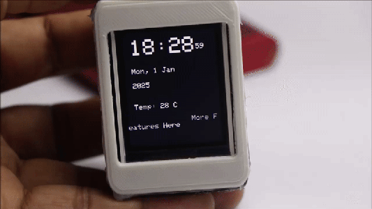

There is no rocket scienec involved to use this project, all you have to do is plug this station to any USB powered source in my case i will ve using a power bank.
The wifi needs to be on so that this weather station will receive real time updates from the server.
After you connect this device to USB power source then the screen become blank and it will search for wifi network and once it is done connecting to wifi you can see the same status as wifi connected on the screen.
Allow a few seconds and now you should be able to see the weather status on the display, i have added time and minute along with running seconds.
In addition to that date, day and month along with temperature.
I live in different time zone and when you are using this project it will automatically show the time as per your zone.
I also left a slot to add another feature, you can add humidity level or any other feature such as motivational quotes if you are willing to in that blank space.

Here is the working video of this project, as you can see how clearly it is showing all the weather components.
I have also left room for more customisations and you can see that on the screen, For example you can add the icons or small active icons that will make the project look much more appealing.
