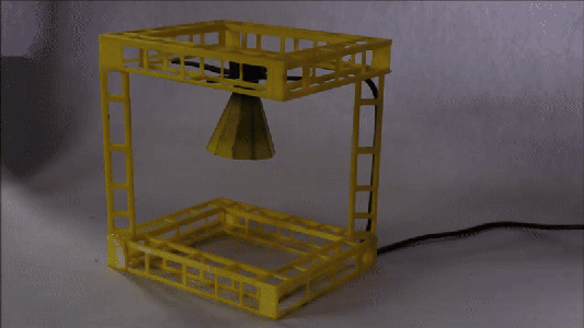

Step 1: Design and 3D Printing
I have made lots of trial and errors and finally came up with this design, The design was made with tinkercad application and sliced using cura slicer.
You can simply check the settings that i used to slice the model, There is no need of any rafts or supports to print the model.
There is a need of post processing after the model is printed, Let me know if you have any way to get rid of this part.
After the model is sliced you can export the model to 3d printer and print the model, The choice of PLA filament color is left to your choice.
I will use bright yellow and black filament to print the model, well this is left to your taste of color.
The most time consuming part is the base and top frame of the lamp, the other parts wont take away much of your time.
The number of parts that is involved to make this lamp is 6
The base and top supporting frame and the side support frames makes it to the count 4 whereas the bulb holder and the plus shaped bulb supports make it to total 6.
Use the files given below to print the model, Just import to any slicer and print the model as per the settings given above.

Step 4: Assembling the Frame
This is my most favorite part, I will also tell you why I'm saying so.
Because I get a chance to see the project coming to life from something virtual that i designed to something realistic and useful!
Start by sanding the base of the side supports and the base support top surface, Use drop of superglue and join the two surfaces of the parts, Hold it firm for few seconds and the parts are now glued well and the strength is sufficient enough to hold the other parts.
The top frame will hold the bulb and I have added this part to the top frame using super glue.
After this is done the bulb holder can be added to the top frame along with wire, Here make a note that the weight of the sealant or you can call it as the insulator that absorbs heat from the bulb will stabilize the entire lamp to stay still in almost all the surfaces.
If your size of bulb is different than mine i would suggest to slightly expand the size of bulb holder, well that is an optional part and i will not recommend to do that.
