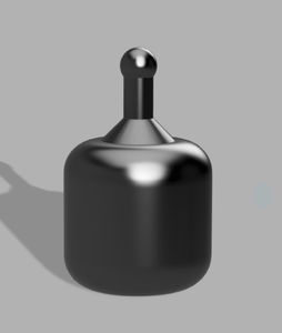

My exploration of body parts is really only a first step and a proof of concept. I would love to continue working on this idea and explore more forms inspired by the engravings of Giovanni Battista Bracelli, but first I had to just make sure my joints and sockets actually worked.
My first attempt was not successful, but did give me hope for the idea. It also helped me to understand the tolerances that I was looking for when thinking about my FDM 3D printer and 1.75 mm PLA (an Ender 3 Pro).
The joints are a ball and socket concept. I created a pipe around the edge of my socket to make the opening slightly thicker so that I could pop the sockets in and out. The ball and socket concept enables some range of motion that is reminiscent of a joint in human physiology.

I printed two bodies with all of the necessary parts to attach to one another.
It turned out 0.5 mm of space was actually too much so I went back in and adjusted my user parameters to tighten the tolerance to 0.3 mm and the print is currently printing.

Step 5: The Parts Work!
The parts work. The range of motion is not very large, but I think this can be tweaked with some further adjustment.
