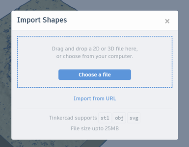

  1. Open Tinkercad and log in with your E-mail Id.
  2. Create New Design to make changes in STL File.
  3. Import STL File Generated from NASA TREK website.
  4. Choose a file from the download.
  5. Our download Moon map looks like this if we choose the same parameter stated.
