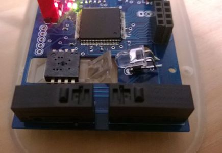

As soon as I provided the first paper sketch one of the designers for ProtoDnD asked me for the dimensions. I put together a PCB which had three constraints on the design of the case:
- a window for the optical sensor and
- pods for screwing the PCB to the base of the mouse and
- a solid mating had to be ensured between the two switches on the PCB and the buttons on the case.
Once I made the PCB with 4 holes at he corner and zeroed in the optical sensor and switches used as mouse buttons, I revised the picture with my measurements. I added the dimensions on the image already uploaded through ProtoDnD's web interface .

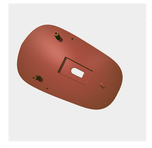

Step 4: Showtime: Output Model From Designer

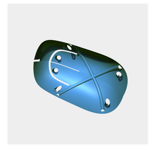

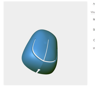

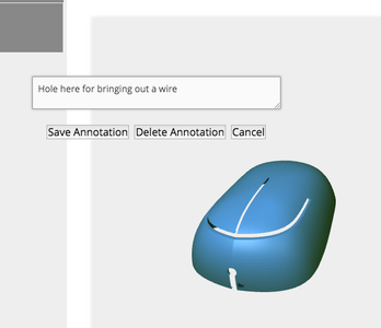

I finally received the a model from the designer on ProtoDnD and this is what it looked like. What is shown above is the final output from the designer. When the designer uploaded a first version of the model, i realized it might be useful to have a hole for bringing out the debug and programming interface for the micro-controller on-board. I conveyed this to the designer by annotating the STL model directly on ProtoDnD's web interface as seen in the 4th image.

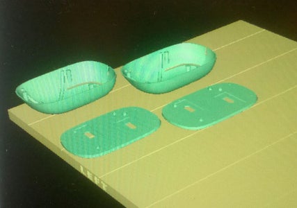

Step 5: Real Stuff: 3D Printing

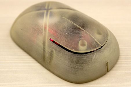

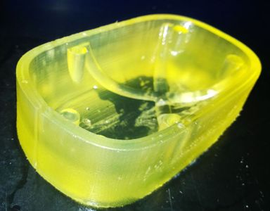

I finally printed the mouse in a Objet 3D printer.

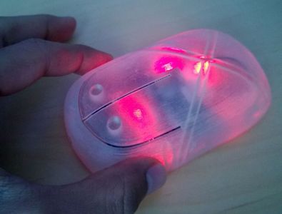

The mouse was finally fitted with the PCB. To get the positioning of the sensor and buttons right, it took two iteration. And finally I had a beautiful 3D printed mouse. Yippee !!
