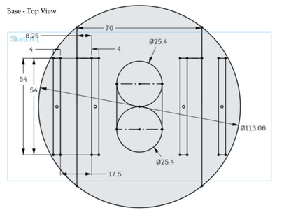

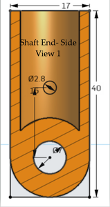

The device has 2 primary components. The base has a hole for the drill bit to go through and insert slots, where the shaft will be connected. the shaft is attached to the base with the shaft end, shown in orange, and attached to the blue base with the red pin, which connects the shaft end with the base using friction, and acts as a pivot point for the drill.

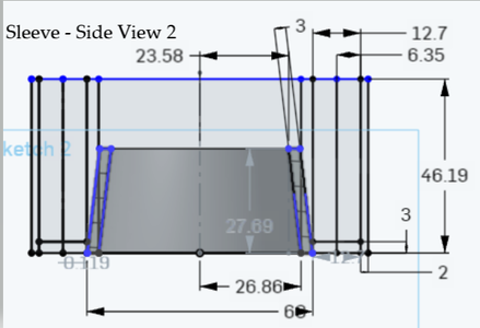

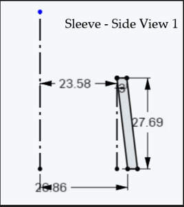

The drill sleeve, colored in gray, has a cone-shaped section that snugly fits over the non-rotating part of the drill. it has to holes beside it for the shaft to go through, so the drill can easily but securely slide up and down. The holes are spaced so that a 7/16 Inch dowel can cleanly fit through them into the shaft end. I took all measurements with a caliper so that the parts will fit my drill exactly as intended
