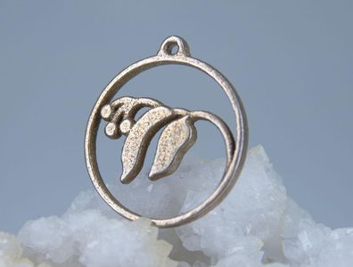

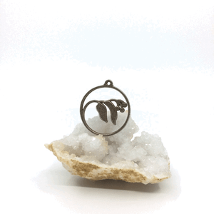

In this lesson you will learn how to make a 3D printed necklace. If you would like a simple project you could pick out a Woodland Path 3D printed Pendant or this design and assemble it with the below supplies for yourself or as a gift. If you are looking for a bit more of an adventure, this lesson will also go over taking a 2D designs & turn it into a 3D printed necklace. This will be a great project for someone that is interested in 3D printing, but is not familiar with 3D layout software or 3D printers.
Step 1: Anatomy of Your Necklace
The Woodland Path Pendants are designed to accept a Stainless Steel Open Jump Ring, on a Black Braided Nylon Cord with a Stainless Steel Spacer Bead.
