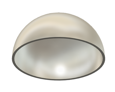

Step 2: CAD the Head Shell
Before starting my design, I took into consideration how large R2 could possibly be. Obviously I wouldn't be able to make him as large as the real R2, but I also wanted to make him large enough to hide my electronics under. Additionally, I had to consider what 3D printer I wanted to use and the maximum volume that the printer could print. I decided to make R2's head nine inches in diameter and make his body slightly smaller so his head could fit on top of his body.
When I opened a new Fusion 360 file, I created a sphere with a diameter of 9 inches and removed the bottom half of the sphere, making it a semi-sphere. I shelled the semi-sphere with an inside thickness of 0.2 inches.
