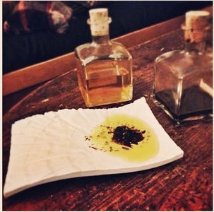

As a personal die hard fan of olive oil and lover of wood working, I decided to design a set of kitchenware that complimented both. I will go through the process I took in creating a 3D printed ceramic oil tray take uses an image as a means to create an interesting surface condition.

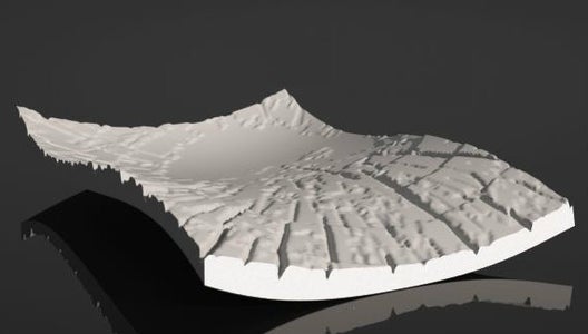

Step 2: Mapping Image for a 3D Relief
Now we are ready to bring this image into Rhino - Grasshopper. Above is a definition that creates of series of points (600 x 400) and maps a desired image with the same parameters. In this case, I set the to 'slider' 20 as a multiplier of the darkness / lightness ratio to get a good bump effect on the output.
Step 3: Giving Thickness to 3D Surface
The next step is to give this undulating surface a thickness. In my case, I wanted to make a ceramic print so I started with at least the minimum thickness I know will print. Keep in mind that this thickness will be the lowest part of the inset surface not the overall dimension.
In Grasshopper, I started by extracting the new surface edges BREP COMPONENTS. I later joined all four edges of the rectangle. Once I had one solid wavy rectangular line, I projected the line to a plane for lofting purposes. So far there were 5 sides established. The final side is the base that can be capped off by connecting the PLANAR SURFACE button to the previous command. (see above). Lastly it is important to join all of these surfaces BREP JOIN button ...There now we have a watertight piece that can be baked.

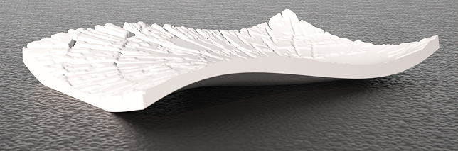

Step 4: Lets Make It Interesting
By using the BEND command in Rhino, you can take an existing object and twist it into different shapes. I decided to make a more interesting wave like shape. Once I was happy with the shape, I lopped off the bottom rounded piece so that it would have a flat piece to sit on a table and not spill precious olive oil everywhere. I achieved this by using the BOOLEAN DIFFERENCE command followed by the JOIN to keep it water tight and thus still 3D printable
