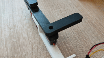

While the painted parts were drying, I started to make the moving part of the project.

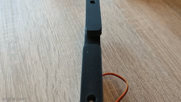

First of all, I fixed the actuator horns in the appropriate places. For the crossbar I used a double horn and for the arms, a simple horn. I glued the arms in place with a drop of hot glue (you have photos above).
I mounted the three actuators, one on the pole and on the crossbar the two actuators for operating the arms. I pressed the crossbar on the axis of the actuator then I pressed the 2 arms on the axis of the actuators. We did not fix with the corresponding screws neither the crossbar nor the arms because it is necessary to align them so that the movements are at the angles of 0, 45, 90, 135 respectively 0, 90 and 180 degrees. For this purpose I used the codes below (the first for the arms and the second for the crossbar) which I loaded into an Arduino Nano on a breadboard and of course, I connected in turn the servomotors that operate the arms (and the crossbar) to the Arduino module.

At the first run of the code I noticed the successive positions, I stopped the movement (I turned off the power) of the servomotor in the 90 degree position and I took out the arm and I positioned it again as close as possible to the desired position. In the code you can fine-tune the movement of the servomotor by changing the values "min" and "max". If we do not define these values, the servo library sets them as follows: min = 544 and max = 2400 (I do not want to go into details but the two values are the PWM corresponding to the angles of 0 and 180 degrees - more on this at servo library page or in this blog post). These values are considered typical but the servomotors are very different, made by different manufacturers, so some adjustments are needed. I changed the values in 10 to 10 steps carefully, so as not to force the servomotor at the ends of the movement (a mechanical noise is heard when the servomotor wants to rotate too much) otherwise the servomotor may fail. When I was satisfied with the result, I wrote down these values (I used them in the final code) Below there is an animated gif with the movements of the servomotor after adjustments
I did the same on the other servomotor on the arm. Now I could fix the arms with screws.
I aligned the crossbar in the same way at 0 degrees and fixed the bar to the servomotor shaft with a screw. You can see the result in the animated gif below.
