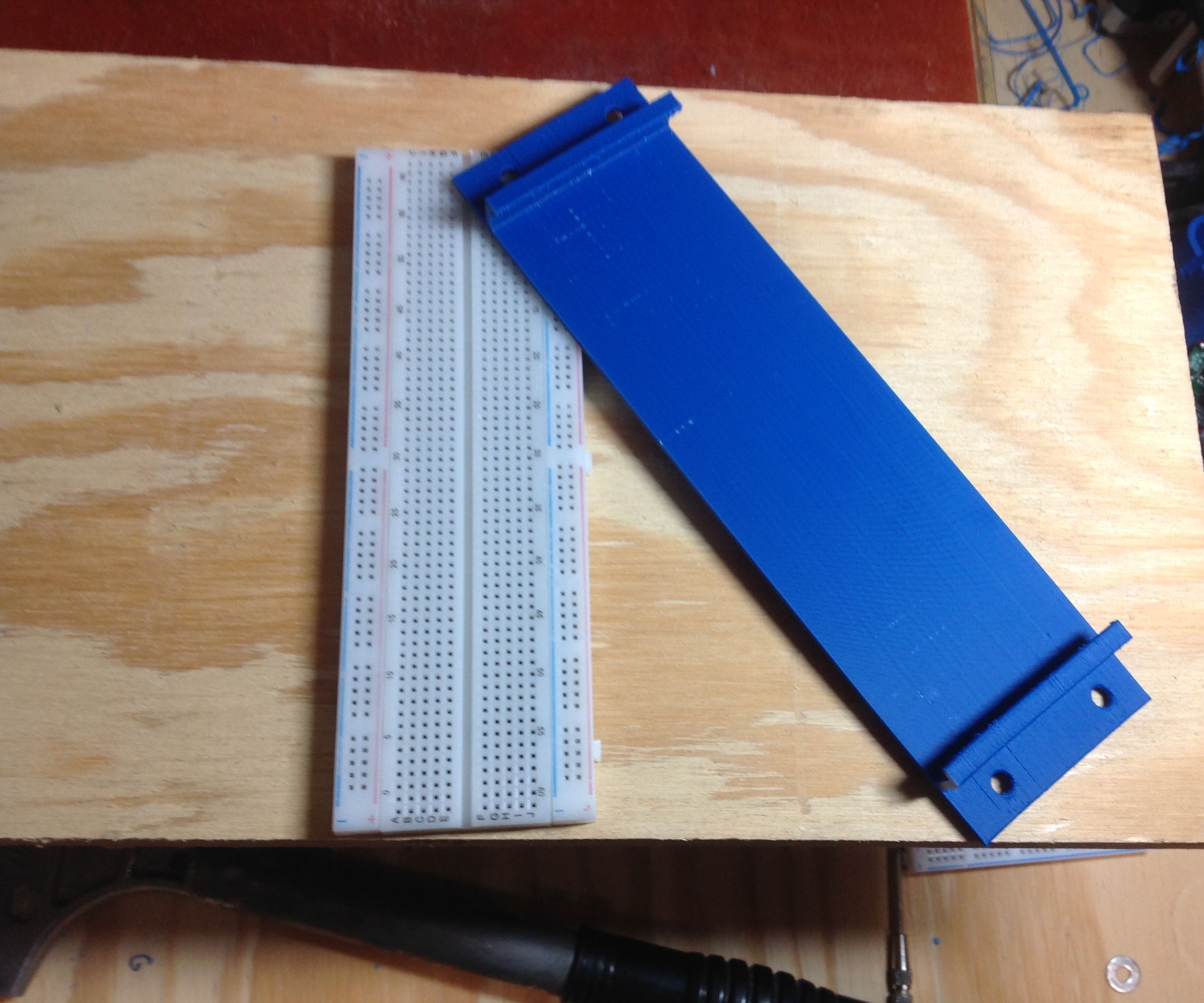

There are many ready made prototyping circuit boards. They come in various sizes and are relatively cheap. Check out ebay. The first photo shows an example board. Short of designing a board and either etching it myself or sending it out for fabrication, these boards are good for simple circuit designs. If there are a lot of components in the design, using these boards and "hard wiring" gets to be tedious.
Recently, I needed to add a relay to my CNC machine. I wanted to add the relay as a "module" so I could add or remove it without major disruption to CNC electronics.
The second photo shows the components to be used which are a relay, two screw connectors, and a diode. The problem I had is that the relay pinout does not match the "standard" prototyping board pad/hole spacing. A solution would be to "dead-bug" the relay on the board, I.e., mount it upside down. However, I wanted a little cleaner fix so I decided to design and fabricate a board using my 3D printer. As will be seen, no metal traces are used.
The last photo shows the completed board.

The photo shows the final board after printing.
Step 3: Assembling the Board
The first photo again shows the components installed on the top side of the board. Blu Tack, the second photo, adhesive was used to secure components until they were wired on the back. The third photo shows the underside of the finished board. Two large holes are used to mount the board in my CNC.
