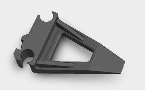

  1. 2x Clamps (RB9.01.060.020)
  2. 4x LM6UU Linear Bearings (12x6x19 mm)
Instructions:
  1. Take the first clamp part
  2. Carefully press 2x LM6UU bearings into the designated bearing seats
  3. Ensure bearings are fully seated and can rotate freely
  4. Repeat for the second clamp
Note: Bearings should slide smoothly without binding

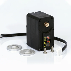

Components needed:
  1. 1x Feetech STS3215 Servo

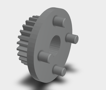

  2. 1x Drive Gear (RB9.01.060.040)
  3. 1x Servo disk (from servo kit)
  4. 1x Servo mounting screw (from servo kit)
Instructions:
  1. Insert the Drive Gear into the servo disk from the servo kit
  2. Align the gear teeth properly with the disk
  3. Mount the gear assembly onto the servo output shaft
  4. Secure with the screw provided in the servo kit
  5. Important: Ensure the gear is properly aligned and rotates smoothly
Step 3: Mount Servo to Main Frame
Components needed:

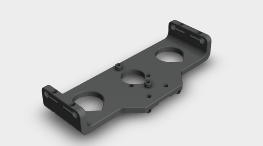

  1. 1x Main Frame (RB9.01.060.010)
  2. 1x Assembled servo with gear
  3. 4x Self-tapping screws (from servo kit)
Instructions:
  1. Position the servo in the designated mounting area on the main frame
  2. Align the servo mounting holes with the frame
  3. Secure the servo using 4x self-tapping screws from the servo kit
  4. Check: Servo should be firmly mounted with no play
Step 4: Install Main Frame Bearings
Components needed:
  1. 2x MR106ZZ Bearings (10x6x3 mm)
  2. 2x M4x8 DIN 7991 screws
Instructions:
  1. Insert the 2x MR106ZZ bearings into their designated positions on the main frame
  2. These bearings will guide the linear rods
  3. Secure each bearing with 1x M4x8 screw
  4. Note: Do not over-tighten; bearings should rotate freely
Step 5: Install Rods and Clamps
Components needed:

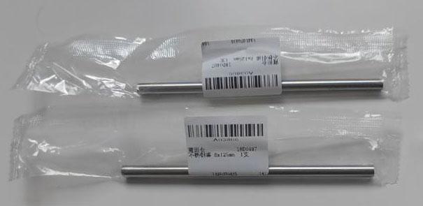

  1. 2x Stainless Steel Rods (6mm diameter, 150mm length)
  2. 2x Assembled clamps (with LM6UU bearings)
  3. 4x M3x20 DIN 7991 screws
  4. 4x M3 DIN 934 nuts
Instructions:
  1. Insert the 2x steel rods through the main frame bearings
  2. Slide the 2x clamps onto the rods (LM6UU bearings should slide smoothly)
  3. Position the clamps symmetrically from the center of the main frame
  4. Secure each clamp to the rods using 2x M3x20 screws and 2x M3 nuts per clamp
  5. Critical: Ensure clamps move smoothly along the rods
