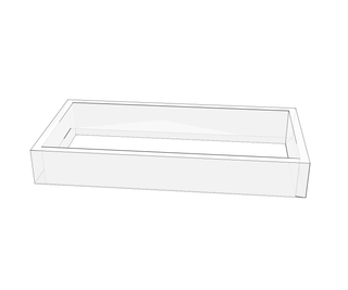

To create an enclosure around 7-segment LED. In this project, I use 0.8" Height 7-segment LEDs. The cavity for 3 digits measure 60 mm Widith by 28 mm. I added 2mm for wall thickness. I made the slope with 1mm height and 2mm width on the top edges.
Procedure:
I use Autodesk Inventor Professional. I created a 2D Sketch. I choose horizontal plane. I draw a rectangle for the cavity. I draw another rectangle and reference to the first rectange and add 4mm. Then center the 2 rectangle with Measure Constraint tools by offsetting 2 sides (right sides and bottom sides) by 2mm.
Use 2 sides to create the slopes of 1mm vs 2mm to shape the top surface.
Save Autodesk Inventor File and export Geometry in STL file format.
Bring the STL file to the MakerBot and print. It takes only about 10 minutes and material cost only a few cents.
