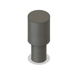

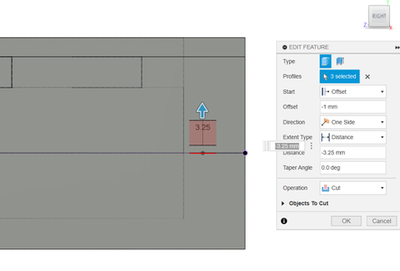

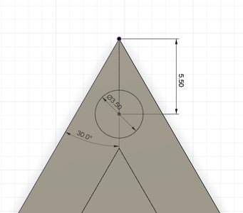

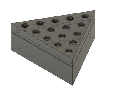

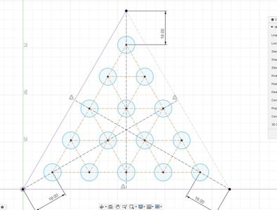

Using Fusion 360, I designed the the box and the pegs. To account for the magnets I embedded in the print, I sketched and toleranced the holes then offset the extrusion by 1mm, and cut the part. The cuts are visible with the hidden line visual style.

Using the Bambu Slicer, I imported the files and sliced them. I scrolled through the layers and added a pause at the last layer of the hole. What this does is stop the print so that I can put the magnets in.
NOTE Make sure to add two pauses: one for the hole on the top part, and one for the hole on the bottom part since they are at different heights.
Afterward, I resumed the print, and the magnets became embedded in the print, resulting in a cleaner look. I am not sure if every slicer has a pause function, but Bambu has one 👌.
