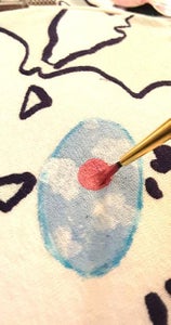

  • Paint: (I used acrylic paint to paint my fabric)

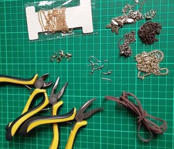

Jewellery hardware:
Depending on your designs and desires. A simple thin string will do for a necklace, but I recommend a nice chain, a few metal jump-rings, earring-hooks and some pliers.

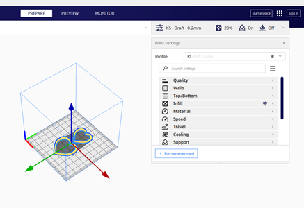

Before printing you need to 'slice' your STL-file with slicer-software compatible with your printer. I use Ultimaker Cura. If you are new to slicing, please check a tutorial first.
The slicer-settings always depend on your printer and your choice of filament. Therefore, I cannot guarantee my settings will also work for you. But to give you an idea, here are my settings:
  • Printer = Easythreed K7
  • Filament = Jupiter, PLA, white, 1.75 mm
  • Layer height = 0,2
  • Infill = 20 %
  • Speed = 40 mm/s
  • Temperature = 200 °C
  • Build plate adhesion: skirt, line count = 3

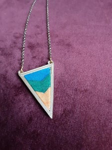

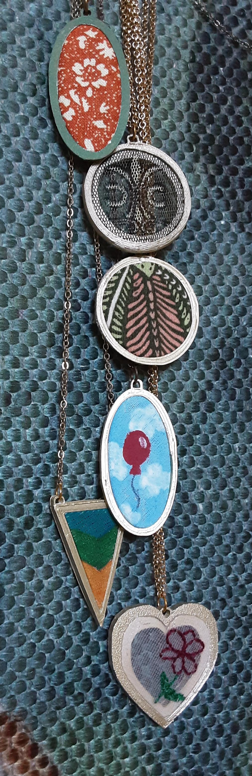

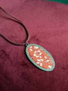

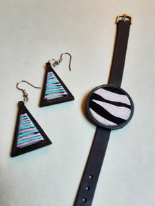

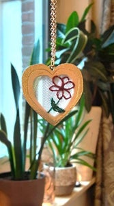

Step 7: Get Creative With Your Textiles
The pendants give you many options to customize your jewellery any way you like and create something awesome that fits your style. The possibilities are endless 😊.
The photos show some examples that I created to inspire you. One of my favorite techniques is painting the textile with acrylic paint. I also tried some embroidery, and used embroidery strings to create a pattern.
Step 8: Add Jewellery Hardware
This step can be as easy as adding a string. I prefer my pendants to be a bit more fancy, so I used some jewellery hardware for this final step. All you need to know is how to open and close a jump ring.
Tip: If you don't have any jewellery supplies you could repurpose an old necklace (perhaps thrifted).
