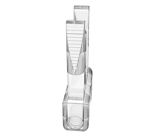

A couple of months ago I was experimenting with different printable hinge designs, and trying to print them pre-assembled. One of those designs was this "H-chain" configuration shown above. Later I came back to it and decided to implement it into a useful project: the 3D Printed Pet Collar.

Once you've acquired a 3D printer and some filament you are ready to print. Download the STL files below and configure the gcode with a CAM software. I printed all my parts with the following specifications:
Layer Height: 0.1 mm
Shells: 4
Infill: 28%
Additionally, the Snap pieces and Mainbody Assemblies will need to be printed with a small amount of support material.
To make the collar shown in my pictures you will need to print one of the Large Mainbody Assembly, one of the Keychain-Loop H-piece, one of the Snap Outer, one of the Snap Inner, one of the Keychain Loop, one of the Connector, two of the Keychain-Loop Pin, and four of the Pet-Collar Pin.
To make a smaller collar, such that would fit a cat or similarly sized animal, simply print the Small Mainbody Assembly instead of the large one.
I also included files for separate H-chain pieces so that you can print and assemble an H-chain of any size to fit your needs.
