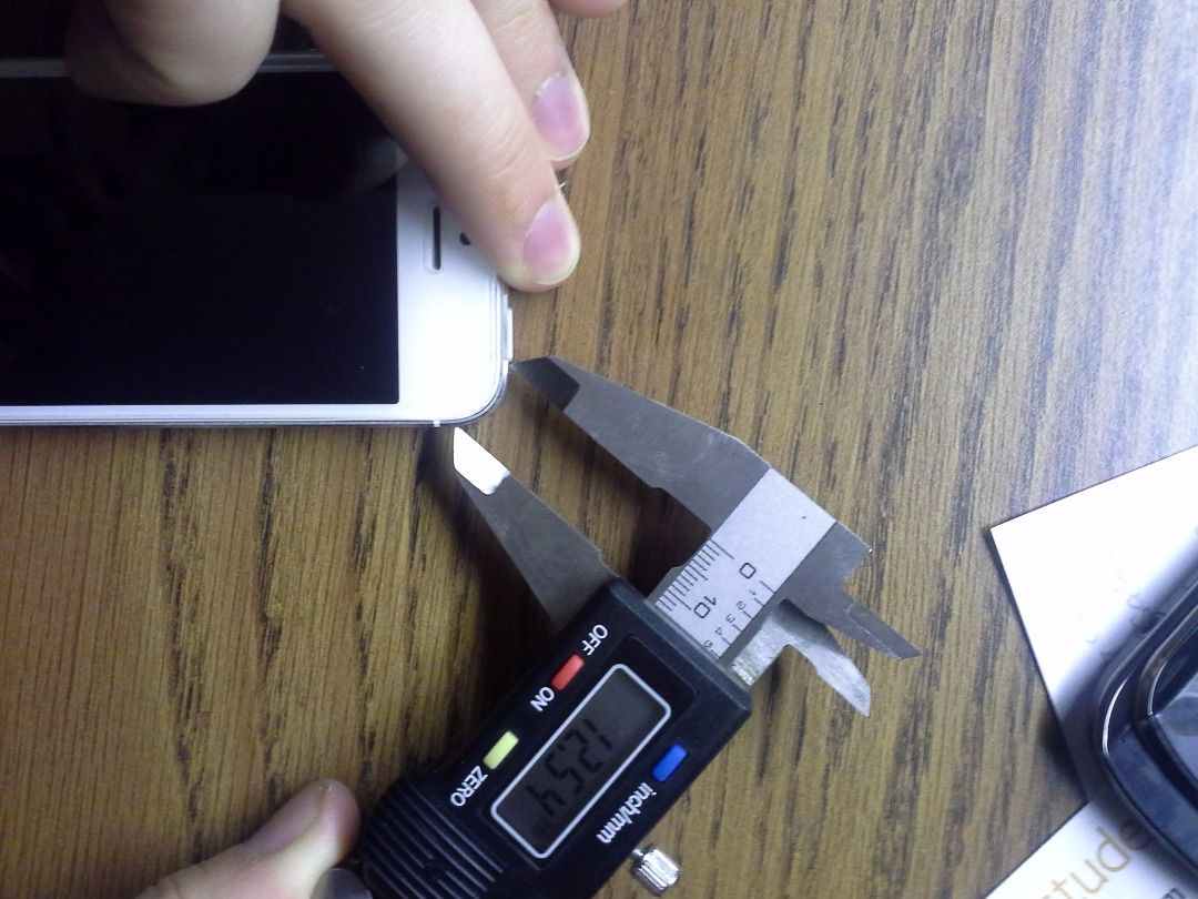

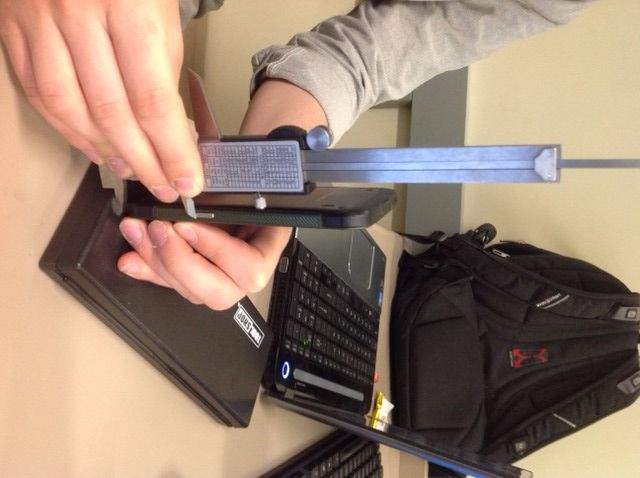

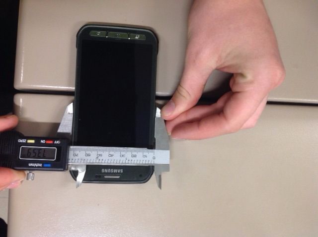

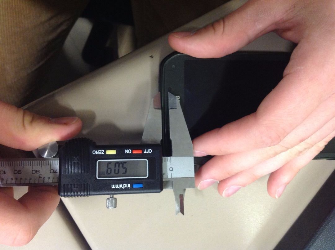

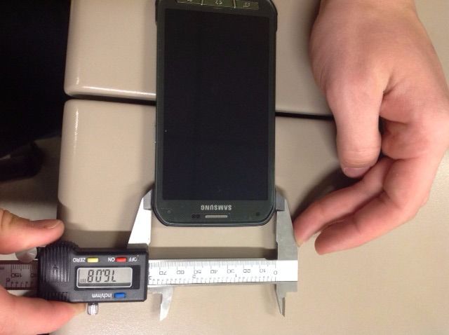

Step 1: Get Measurements
ote: While taking these photos, I accidentally pressed the zero button on my calipers, so the measurements in the photos may not be accurate. The photos are mainly as a reference as to how to get the necessary dimensions.

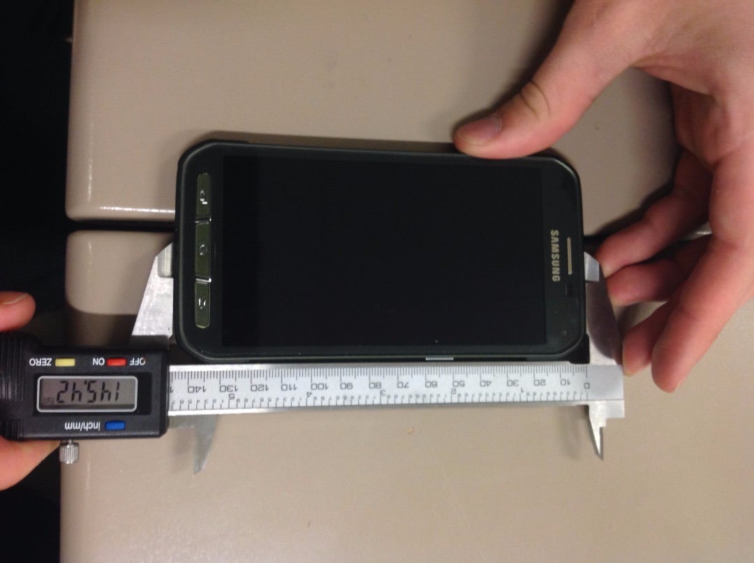

Measurements Needed:
  • Overall Height
  • Overall Width
  • Narrowest width (if different than overall width)
    • When in the modeling phase, ensure that the overhang of your lip to hold the phone in (width - 3) is wider than half the distance between the overall width and the narrowest width)

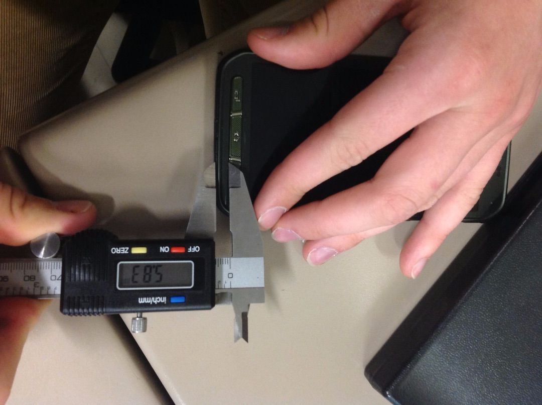

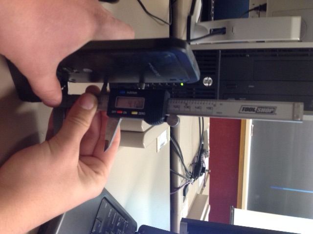

  • Distance to top and bottom of each button or button group
    • In photo 4, you can see that I have placed the top of the phone on a flat surface and am using the inner dimension side of the calipers to get an accurate dimension of the location
    • If you have trouble getting this measurement accurately, just exaggerate the size of the hole you make for the button to ensure space is made for the button.
  • Distance from the edge of the phone to the home button(s) and from the edge to the edge of the camera
    • When in the modeling phase, ensure that the overhang of your lip to hold the phone in (width - 3) is less than these dimensions
  • Distance to the charge port and the headphone jack
    • It is best to measure these the same as the side button dimensions, but you can also just exaggerate these dimensions as with the button location dimensions

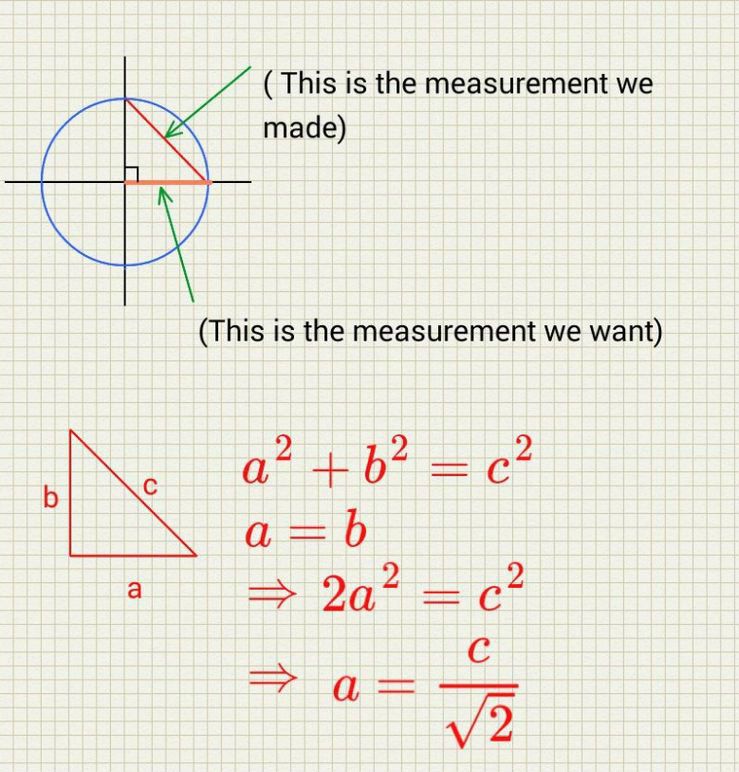

  • Radius of Corner
    • (yes I know that this is with an iPhone, but I didn't have the phone with me that I originally designed the case for and forgot to take a picture of this measurement)
    • measure this dimension from about where the curve starts to flatten out
    • To get the radius used in modeling, divide this measurement by √(2)
      (see explanation below)
    • In the photo example (iPhone 5) the radius would be 8.9 mm
  • Overall Thickness of Phone (no image)
    • measure the thickness of the phone

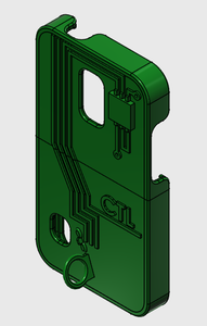

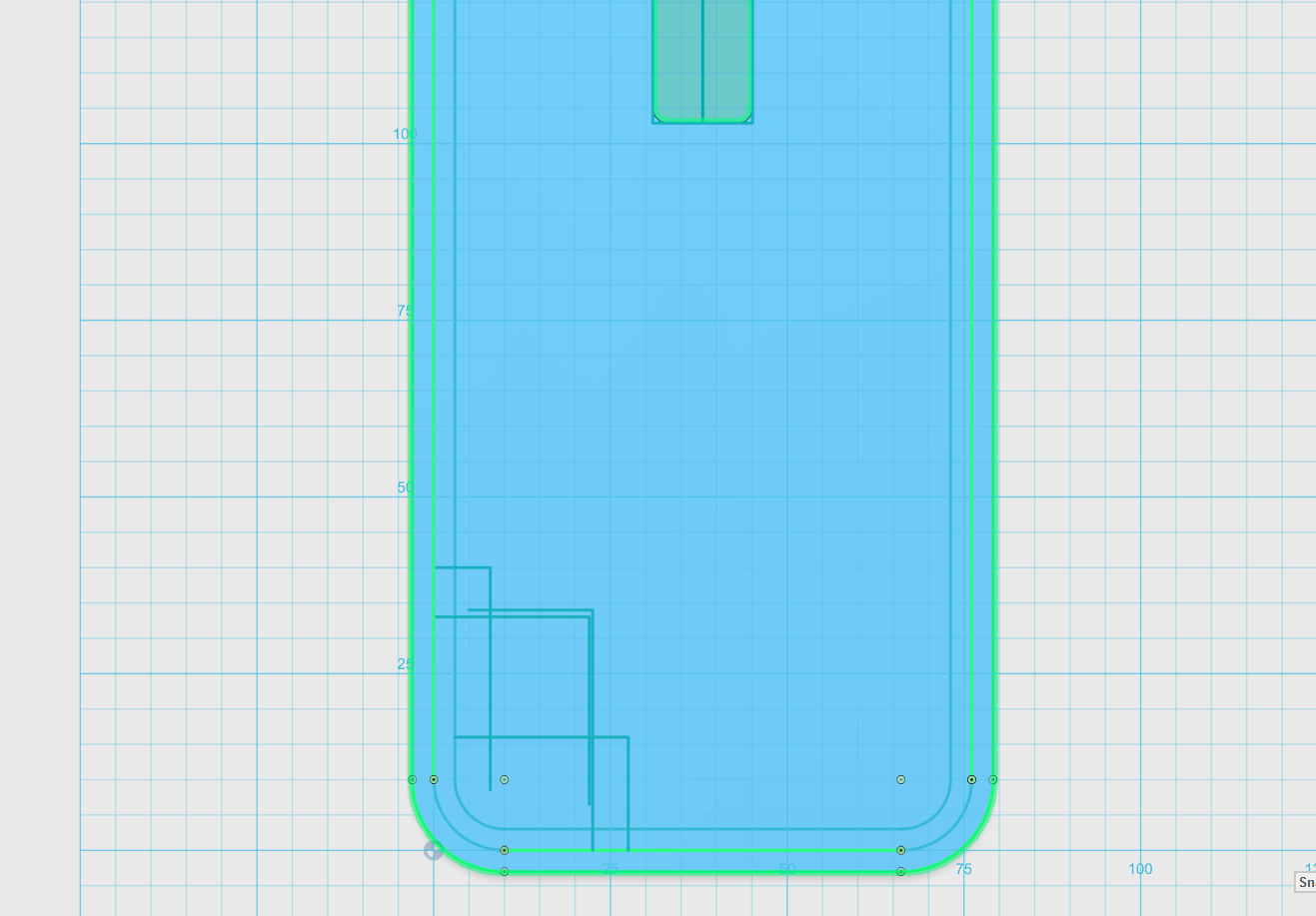

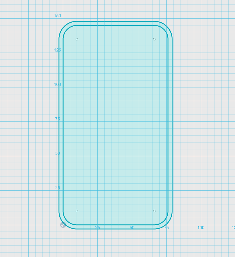

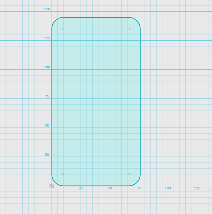

  1. Making the basic shape of the case. (0:10)
    1. Draw a rectangle that has the same dimensions as the overall height and width of your phone.
    2. After drawing your base, filet the corners to match the radius of the corners on your phone.

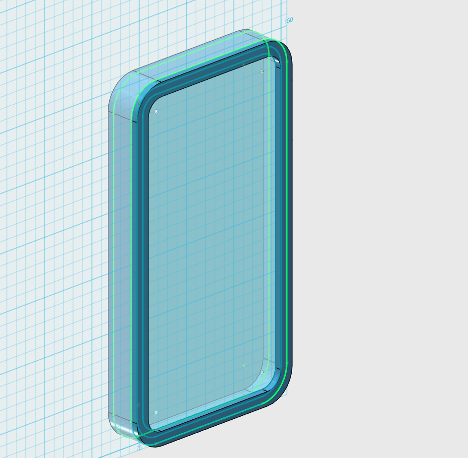

  2. Making the edges and openings (2:20)

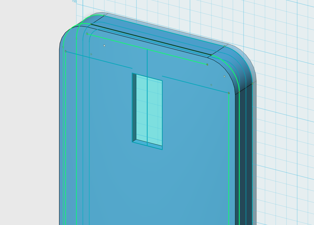

    1. Use the offset feature to offset the drawing by 3mm
    2. Raise the edges of your basic rectangle
    3. Next fill in what will be the back of the case
    4. Offset the outer edge of the front by - 6mm and extrude 3mm to make lip to hold phone in case
    5. After forming the basic edge, using the measurements that you took previously, remove the space where you would find the camera and speaker.(5:22)
    6. After that, move to the sides of the case. Use the same process you used when making the openings on the side. (Note: Precision is key in this area).(9:28)
    7. When finished making the spaces, filet all squared edges on the case. This will make it cleaner.

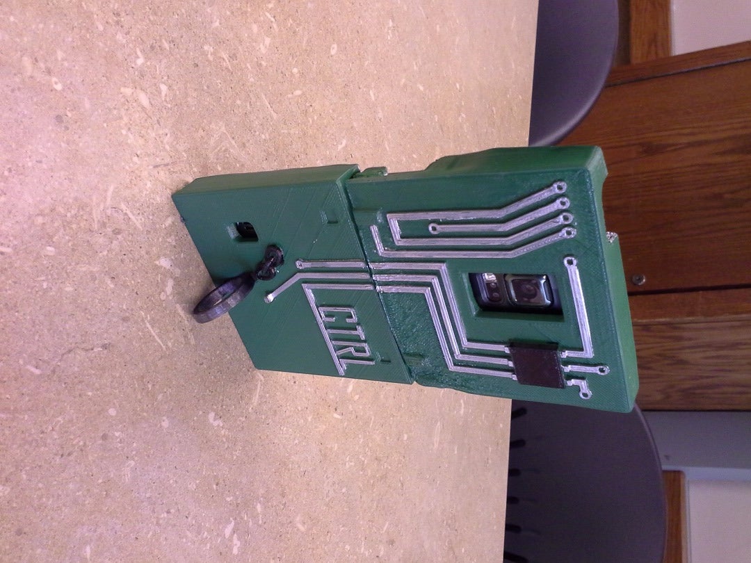

  3. Rendering the back design(15:10)
    1. Begin by drawing a line resembling a circuit vertically from the top of the case to the bottom.
    2. Select the first line and paste it 9 times to create 4 separate circuit links.
    3. When finished create a square in the upper right corner of the case to resemble a chip.
    4. Using the same process as before, create circuit links going into the chip.
    5. When finished with this process, raise the pattern and chip to sit above the base.
    6. When all this is finished, use the text tab to type CTRL into the design.(17:40)
      • (note, there is a typo in the video as it says CTL instead of CTRL)
    7. When finished, raise the text as well.
    8. Next, to create the shackle and chain, draw a rectangle and two flat ovals.(20:45)
    9. Make the rectangle sit lower in the case, making an indent or slot.
    10. Then, to create the raised link, draw a rectangle that connects the two oval links.
    11. Raise the rectangle and filet the edges, making it appear round like a link.
    12. Filet the edges of the two ovals as well.
    13. In order to create the shackle loop, start a new design page(24:50)
    14. Draw a circle
    15. Draw a rectangle and fuse the circle to the rectangle.
    16. Raise the whole piece; this will sit in the rectangular indent you made earlier.
