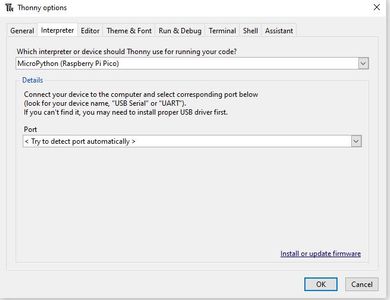

I will start by uploading the python code to raspberry pi with the help of thonny programmer, connect the raspberry pi board to computer with the help of USB and also pressing the boot button.
Open thonny and use the code given here and after installing micropython to board, run this and later save the program with the name .main.py and after this is done you can use the pi board like normal microcontroller.

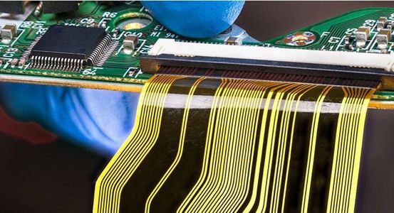

A revolutionary solution that combines the best of both rigid and flexible circuitry to elevate your electronic projects to new heights.
Don't miss to check their assembly offer here , For a Limited time only 29$ for 20pcs
PCBA & Online quote available with 24h delivery services
Their expertise in advanced manufacturing techniques offers a seamless integration of rigid and flexible components, ensuring enhanced reliability, durability, and space-saving benefits.

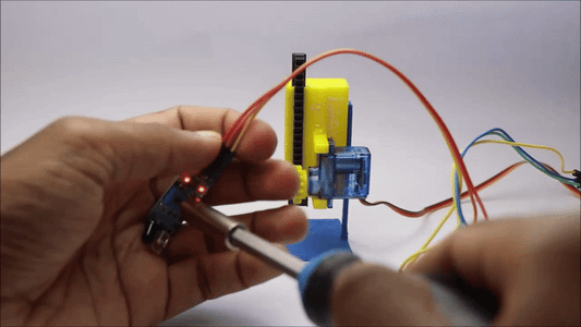

i will start by adding the gear to the horn of micro servo, you might need to add drop of superglue and also use screw to ensure that the gear is intact this is because the gear will undergo lot of load and it needs to be very intact to the shaft of servo.
Connect the slider to the mainframe and by hand move the slider back and forth to make sure there is no obstacle on the working path.
Now add the servo to the frame, use hot glue to attach it to the frame and allow to dry completely.
Test the mechanism by connecting the IR sensor, You may need to adjust the IR sensor sensitivity by adjusting the potentiometer.

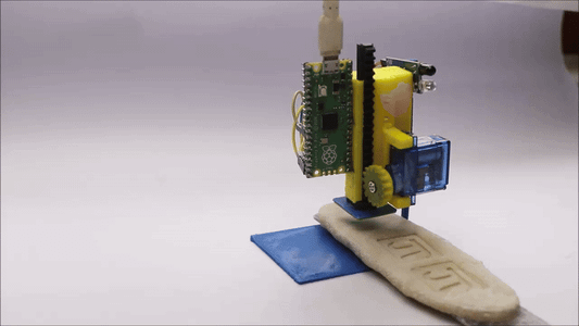

If everything works fine attach the pi pico board to the mainframe using hot glue, followed by attaching the IR sensor to the frame.
Finally add the stamp(choose your own design) and add to the stamping area, allow to dry and now you are good to go.
Step 4: How to Use
Believe me using this device is so much fun! all you have to do is connect the pi board to USB source and allow it to reset for few seconds and then place the dough or paper or cloth below this device(pressing area)
When you get your hands in front of the IR sensor the stamping mechanism activates and in no time it will press the pi symbol on the dough and we have the pi ready.
