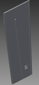

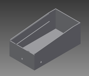

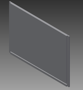

Step 1: Print Out the Cabinet & Backbox Files
Download the attached zip file, which includes both the .stl files for use with a 3D printer, as well as the Inventor source files in case you want to modify the parts to fit your own design.
The files are, as follows:

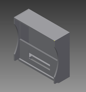

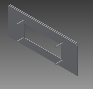

Backbox
  • backbox_back (The back of the backbox...what a tongue twister!)
  • backbox_base (The piece that will adhere to the actual playfield)
  • backbox_base2 (Adheres to backbox_base, separate because some 3D printers do not print the shape correctly when the two are printed as one)
  • backbox_lcd_holder (Holds the LCD in place in the backbox, with supports for the LCD)
  • backbox_left (The left of the backbox)
  • backbox_right (The right of the backbox)
  • backbox_top (The top of the backbox)

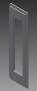

Cabinet
  • cabinet_back (The back of the cabinet)
  • cabinet_bottom (The bottom)
  • cabinet_front (The front, with hole for Start button)
  • cabinet_left (The left, with hole for button to actuate flipper)
  • cabinet_right (The right, also with hole for button)

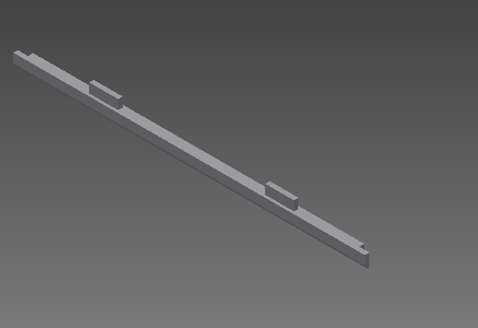

  • cabinet_lockbar (A bar that can be fit into cabinet_front, holds the glass/acrylic from falling out)
Any 3D printer should handle the .stl files, I used the Makerbot Replicator. Make sure to scale up for inches, if necessary.
Step 2: Assemble the Cabinet and Backbox
With some Epoxy (Or hot glue, if you don't have Epoxy), assemble the pinball machine's cabinet and backbox.
The parts are labeled as if you're facing the machine from the front. For example, cabinet_left is the left side of the cabinet, cabinet_front is the front piece that faces the player, etc.
The pieces all fit together by putting glue in the mating surfaces between them, then holding them together until the glue bonds. It's easiest to start with cabinet_left and work your way clockwise, so the next piece to glue to it would be cabinet_back, then cabinet_right to that, then insert the cabinet_bottom piece into the slot at the bottom between all of these, then finally glue the cabinet_front in place. Don't glue the cabinet_lockbar in place, because you'll need it later if you need to take your glass/acrylic out!
It's a similar process for the backbox. Note that backbox_base is different than backbox_base2. Although they are glued together, one side is used to attach to the cabinet, and the other side is for attaching the rest of the backbox. The piece that has the gap around all 4 edges is the piece that you'll attach the rest of the backbox pieces to, whereas the piece that only has gaps on 3 out of the 4 sides is used to attach the backbox to the cabinet.
It's recommended that for the backbox you do not glue the top piece in, nor do you glue the LCD holder in. This lets you wire everything together and remove the backglass and LCD if later needed.

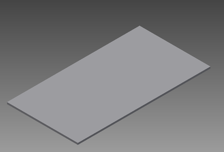

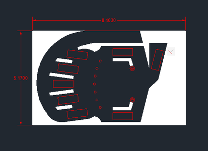

Step 3: Cut Out the Playfield
Now for the fun part, the playfield! I have attached an AutoCAD drawing of the playfield design I used, yours can be different. The only specifications required is that the playfield must be 5.17 inches x 8.403 inches. The design of the cabinet gives you 1.5" of height to work with, so you can stack multiple layers on top of each other to create a guide for a larger ball (I used 4 layers, I would recommend at least 5 or 6).
The design I provided fits standard size LEDs, as well as has openings for a standard-sized lever switch. If your ball is too lightweight for a lever switch, I go into an alternate method for using the scrap wood as a switch in the next section.
For my design, I made engraving markings on the playfield to indicate where to glue the extra pieces. This really helped, and provided a surface for the glue to bond to. Wood glue works very well for gluing the wood together.
