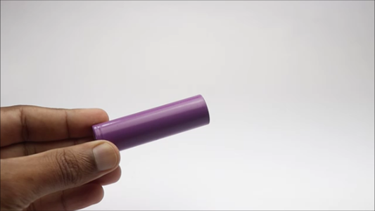

The 18650 batteries can be charged with electricity or a solar power, In the daytime you can charge these batteries and during the night you can use this, The 6000mah batteries will give long hours of backup.

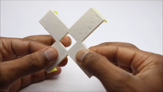

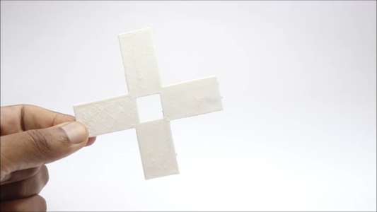

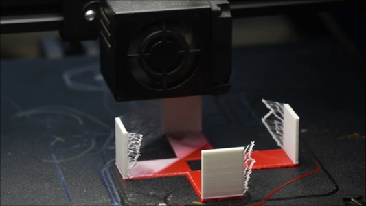

The design is in the shape of a plus and in the center i have given a space that will hold the LED, The 4 legs will be connected to back part of the battery holder.
The height is elevated so that the PC fan can be added below, This will allow sufficient space.
Also the parts will consume less materials at the time of printing that in return will reduce the printing time to a great extent.
The air coming out(hot air) from the LED panel can flow freely to the outside since none of the parts will obstruct airflow.
I have given the STL files below, Download them and open on any slicing software, There is no need of using any rafts or supports at the time of printing.
The choice of pla filament color is left to you, You need to print 3 parts.
The first one is the plus shaped frame and the second is the battery holder and the last one is the frame but with no legs you can do this by stopping the printer when it starts to print the legs.
Print time is less than 2 hours and there is no need of any post processing after the print is complete.

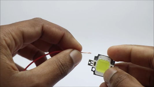

The LED comes with non soldered pin and the back plate is made of metal so the challenge here is the frame back part has to be airborne and in case if you are using water cooled or fin cooled panels you can attach these to them.
That is another complex task which will need more and more components and it will also increase the overall cost of the project along with increase in the size of project.

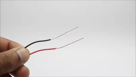

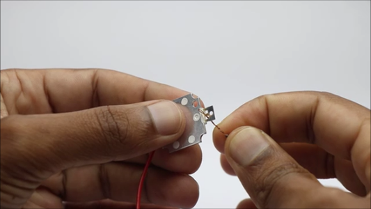

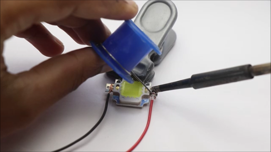

I solved this problem in this way, I soldered the copper wires to the dedicated pins with the sufficient solder deposit, Repeat the same for the other side too.
You can also use single stranded wires that is thick but in few cases if the cooling systems fail there is high chances that the entire wire lines will stop working because of heat.
I recommend using thick copper wires on this LED panels because it is good in working in heat conditions.

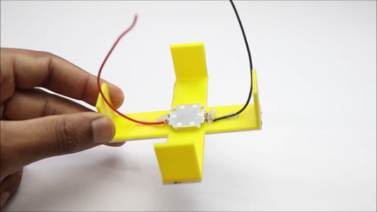

Now this LED is ready to be added in the 3D printed frame, in the other way these wires also help in the LED suspending on the frame so adding a wire of decent quality is recommended.

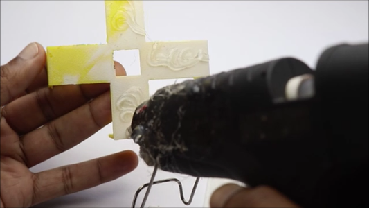

Step 3: Framing

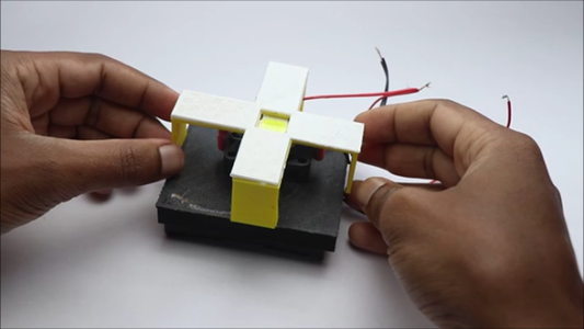

Frame is the part that is attached to the backside of the battery holder and it holds LED as well as the cooling fan, So it has to be strong and i have given it a additional layer of strength by adding a piece.
Add hot glue all over the surface and gently place the plus shaped part, You can make this part by 3d printing the frame and removing those sides(not to print them at the time of print)
Press on this part for some time until the excess glue is spilled of and the glue becomes dry.

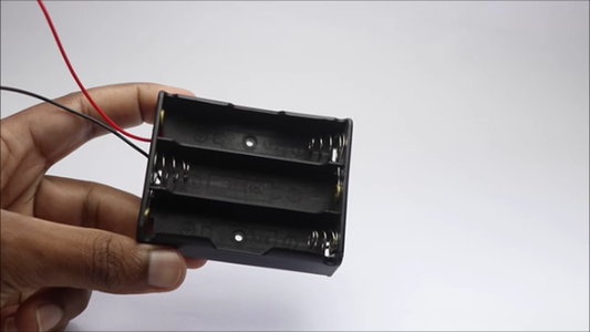

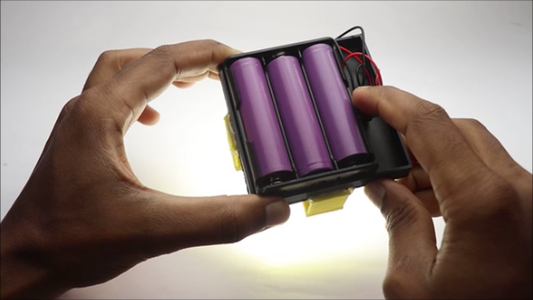

Place the LED panel on the frame and glue the wires as shown in the steps above, Now the battery case needs to be placed inside the 3d printed case.

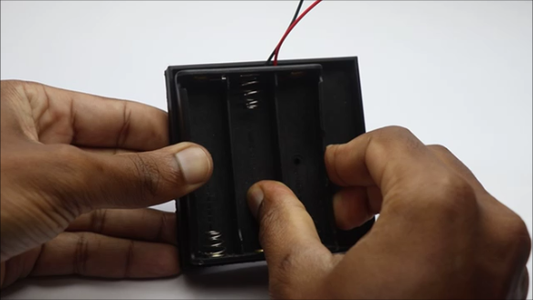

I have designed this battery case so that you can fit a battery holder along with 1 or 2 switches, in my case i will use a single switch.
Drop the hot glue inside this frame and place the battery holder and allow to dry completely, This will finish the base part now we can work on the air cooling part.

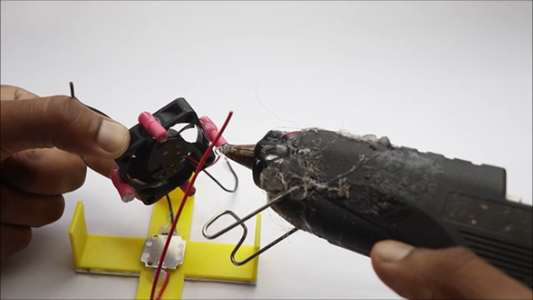

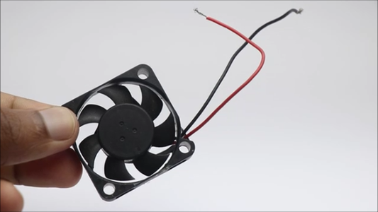

Step 4: Cooling System
The DC fan also few call a pc cooling fan was scavenged from my old mini CPU unit, You can find this at any computer service center or hobby electronics shop, Consider getting a small one and i have given an online method of getting this the supplies section above.
The frame that i used was designed to fit a 4x4cm PC fan, So here i will show how you can properly configure this on the frame.

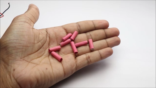

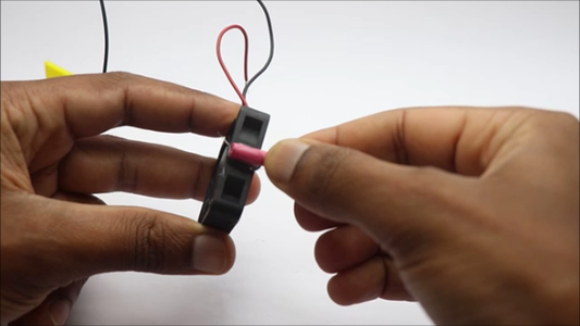

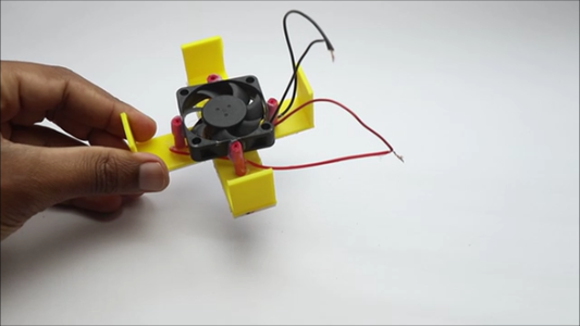

I made tubes of paper that measured 1.5cm each and with the help of hot glue i joined this on the sides of PC fan, Now you can connect both the wire and if necessary trim of the additional cables.
Repeat the same steps for all the other remaining sides of fan, Allow to dry completely and adjust the tubes so that everything is leveled.
Check the alignment and now to all 4 ends of the tube add a drop of hot glue and now press this on the 3d printed frame, Hold it for sometime and when it becomes dry the cooling setup is ready.
This setup can be placed on the battery holder using the hot glue, Secure the joints well with decent amount of glue and if necessary you can add additional layers of gluing too.
Step 5: Finish and Testing
This is the fruit of our effort! The working of this project is very good to see.
I have intentionally connected the dc cooling fan and LED to the same power source and both work using the same power from the battery.
If you have proper control boards like the PC fan speed controller or a brightness controller for LED you can use it considering the fact that if proper power is not received for the PC fan the air flow becomes obsolete and it will cause heating on the LED back panel damaging the LED also it may heat up the 3d printed frame.
So i would suggest not to use any other controller and better to allow both the electronics(PC fan and LED) with the same power that will run at their full capacity thereby giving out the best performance.
This is a great tool to carry when you are camping where you can charge the batteries during the day using solar power and using these batteries to power this lamp on the night.
The lamp is very bright and can brighten up the surroundings at the press of a button.
