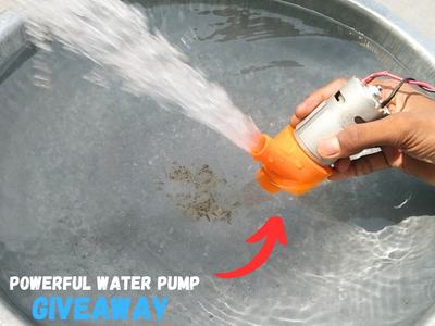

Hello Friends, welcome back in my new Instructables, today I designed this 3D Printed Powerful Water Pump which is based on 775 DC Motor. It helps me a lot in my some daily works, like I can wash my pet, water my plants, wash my vehicle and much more work. It's a best tool for those who had doing these types of work in there daily life. It's a easy to make & easy to use, So now let's make it step by step

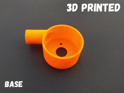

  • First take your motor and place the 3D printed base on it and tighten it with the help of two screws using a screwdriver (See Image 1)

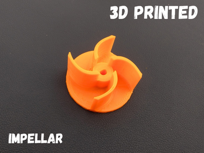

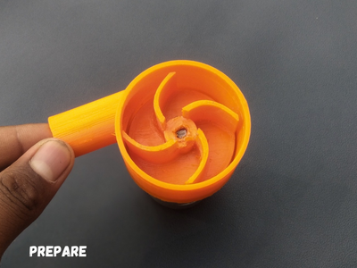

  • Now take your motor and place your impeller on the motor shaft and press it a little so that it fits easily on the motor shaft (See Image 2 & 3)

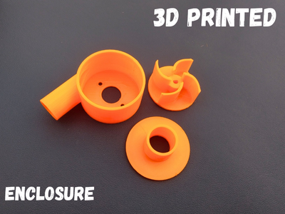

  • Now put the upper part of the 3rd printed part on it and apply a little force so that it fits easily in it's place (See Image 4 & 5)

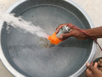

  • And now close it well with the help of super glue and Apoxy Resin gun so that water does not leak from anywhere (See Image 6)

Now let's provide a power to the motor, and see it in action. As you can see in the image, it's pressure is too high and it's a best tool for some house works, which one I mentioned in Introduction.
