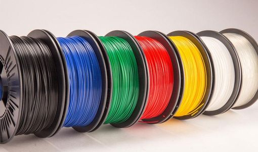

All you need for this is an FDM 3D printer with a decently sized bed (I used an Ender 3 Pro).
Any rigid filament would probably work, although I used PLA.
You'll also need a slicer. I used Cura but any should work.
