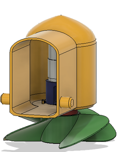

Step 1: The "Impossible" Design Challenge
I started this project with two seemingly impossible design constraints to make it interesting:
  1. The body of the sea scooter had to be a single, fully enclosed 3D print. This "print-in-place" method meant I had to figure out how to add all the internal components during the printing process itself.
  2. The body had to be waterproof and hermetically sealed, with no holes for a motor shaft, wires, or connectors. This meant I needed a way to get power and control signals into and out of a system that has no physical connection to its outside environment.
These two challenges guided every design decision I made.

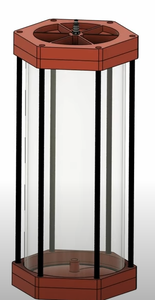

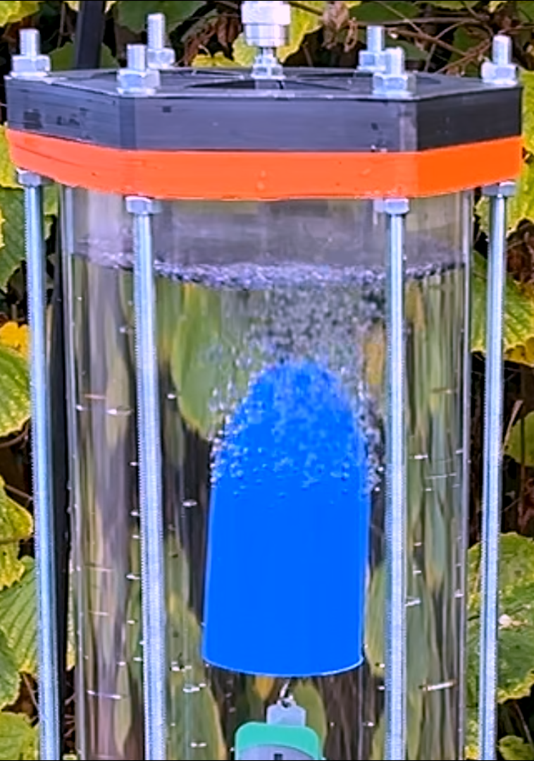

Step 2: Making a 3D Print Watertight
Before I could build the sea scooter, I had to answer the most fundamental question: can a 3D print be truly waterproof? I designed a pressure-testing rig to simulate underwater conditions, testing various filaments and post-processing techniques. While many methods failed, my experiments proved that a simple epoxy coating was able to stand up to significant water pressure. This was a critical first step, as it confirmed the project was even possible.

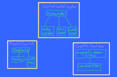

Step 3: Designing an Underwater Wireless Control System
I knew that traditional wireless technologies like WiFi and Bluetooth would not work underwater, as water absorbs their high-frequency signals almost immediately. My solution was to use the power of magnetism. I designed a control system that uses a combination of a simple reed switch and a more sensitive Hall sensor to detect a magnetic field from outside the hull. This provides a non-contact, robust way to get control signals into the sealed hull.

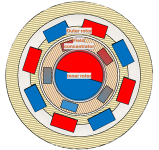

Step 4: Building a Non-Contact Magnetic Drive System
To solve the hermetic sealing problem for the propeller, I designed a non-contact magnetic gear. This assembly uses two sets of magnets to transfer torque through the plastic hull itself, eliminating the need for a physical shaft penetration. The internal magnetic rotor, driven by the motor, transfers 'magnetism' though the iron 'magnetic conductors' that are embedded into the hull's wall. This then causes the outer magnetic gear to turn, somewhat counterintuitively in the opposite direction and at a slower speed. my design gave a 4:1 reduction gearing. I also created a test hull to test the max thrust that this gear could transfer using an in bath testing rig with a range of propellers.

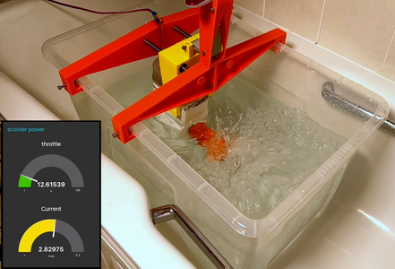

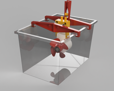

Step 5: Testing the Drive and Control Systems

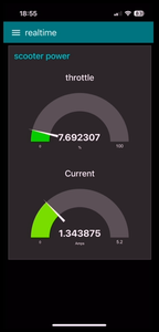

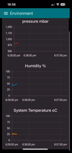

With the magnetic gear and wireless control systems designed and tested it was time to test it all in a controlled environment. to do this I created a bathtub test rig that would enable both the thrust (using some luggage scales) that the magnetic gear could provide with a variety of propellers and the operation of the wireless control systems in a realistic environmental setting. To record the s system state and environmental monitoring sensors built into the sea scooter I built a wireless IOT data collection gateway using HiveMQ to collect messages and NodeRed to read these messages and display them on a real time dashboard that I could access from my Phone during the testing.

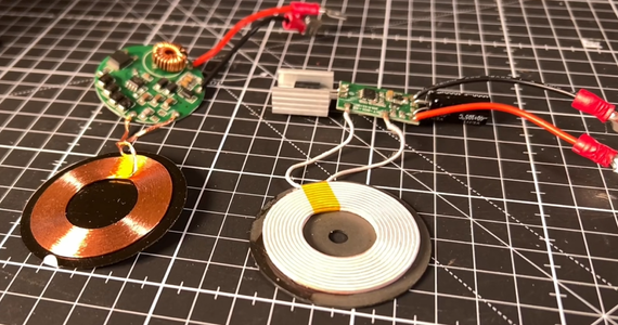

Step 6: Powering the Sealed Scooter
Since the scooter has no holes for a charging cable, I had to design a wireless power and battery system. I built my own custom battery pack using eight LiFePO4 cells, which gave me a 24-volt (26 V in reality), 2.5 Ah pack that fit snugly inside the hull. I then designed a wireless charging system that could get power through the hermetically sealed hull, which was a mini-project in its own right.
