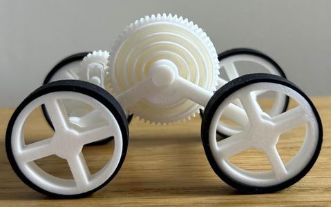

This is a small pull-back car, fully 3D printed and just under 50 mm in size. I made it to learn more about how gears work and to see how accurately my printer could handle moving parts. Everything is printed; gears, axles, even the spring. The model fits together without any extra hardware. This project shows how a pull-back mechanism works from start to finish. Important Note: This project requires a 0.2 mm nozzle. A standard 0.4 mm nozzle will not print the smaller parts accurately enough.

Step 3: Assemble Gear 1
  1. Press-fit the Large Gear and Medium Gear together.
  2. Add a tiny drop of glue on the outer edge of the spring and on its hub (Indicated in green).
  3. Insert the spiral spring into the back of the Large Gear.
  4. Push the Gear 1 connector axle through the assembly allowing for the axle to poke out around 1/0.5 mm each side, expect a snug fit through the spring.

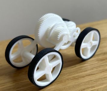

Step 6: Build the Chassis
  1. Lightly glue the ends of the Gear 1 connector and the Gear 4 connector (Indicated in green), then insert them into chassis 1 & 3.
  2. Then connect Chassis 2 to Chassis 1, Handle Chassis 2 carefully, it’s thin. If it snaps/cracks at its ends, a bit of super-glue should fix it.
  3. Slide Gears 2 and 3 into place between Chassis.
Step 7: Gear 5 & Wheel Assembly
  1. Insert the wheels connected to the axle in between chassis 1 & 3.
  2. Slide Gear 5 onto the rear axle; add a bit of glue inside the bore (Indicated in green).
  3. Push the axles through all chassis and press on the other wheels.
