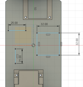

Step 16: Securing the Electronics
Because you are probably using different components to me I will do a short guide of how to secure the components.
All you need to do is measure the width of the component and add at least 3mm and that is the length of the line that is needed then you can screw in screws that are about the right height and put a rubber band over the top.
You can edit the sketch that says EDIT THIS... to change the placement of the holes.
