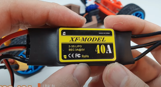

  • ESC 40A for Brushless motor

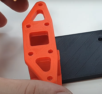

Step 1: Design Your the 3D Model
As a mechanical engineer, I am passionate about designing and assembling various projects, and I'm excited to build some cool stuff from the ideas to design and 3D printing it in real life. I choose RC car because I really love RC cars actually. For this model I've spent about 2 weeks to design it in Autodesk Fusion 360 from the original ideas. It's really a great experience when you can go through the process of designing, 3d printing and assembling your design. Here are some of the pictures of it.

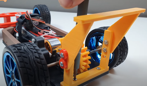

Step 4: Assemble the Rear Axels
After finishing the chassis, let's move on to the rear system. Because I use the brushless motor for this project, I have to reduce the speed for better performance, but I was wrong, the speed is still really fast, it makes the car hard to control. I will design another one in the future and have some upgrades from this project.
First you need to attach the shaft holder to bearing and mount it to the chassis. Just use some regular m3x15 bolts and nuts for this part. Because the shaft is quite bigger than the holding bearing, so I have to use sandpaper for making the shaft smaller than the bearing. I don't know if it's good or bad. Hope that I can get some recommendations from you guys. For the driven gear, you have to fix it to the shaft with M3 bolts.

After fixing the rear axle to the shaft holder, As I mentioned before, you need to prepare the 65 mm wheels and the hex coupler 4 mm for this car. These components will come together and the cost about 8-10 USD for 4 wheels and the couplers depending on the locations. We need to fix the coupler to the shaft first, then attach the wheels with 2 M4x10 bolts.
For the brushless motor, attach it to the mounting bracket that I've design to the chassis the same way as other components. After fix the motor to the chassis, make sure that you adjust 2 gears connected correctly. For the smaller gear, I use adhesive to mount it to the brushless motor which cause a lot of problems when the car is running.

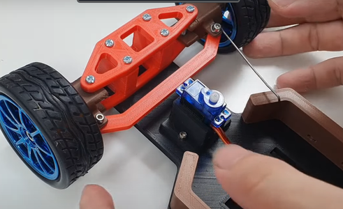

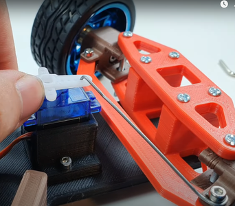

Step 6: Assemble the Front Axle
We've walked though half of the way to make this project. Let's continue to build the front axle with the basic steering system. I use the SG90 Servo to control the front wheels. I think it's a bad steering system, but it will have some upgrades in the future.

Connect the ESC to the brushless motor. Brushless motor has 3 wires, VCC, GDN and Signal. The ESC also has 3 wires as the same as the motor. Make sure that you connect it to the right terminal.
  • VCC ESC - VCC Motor
  • GND ESC- GND Motor
  • Signal to signal
Connect the ESC and Servo to the RX
  • Servo to channel 1
  • ESC to channel 3
And the last one, connect the battery to the ESC.
