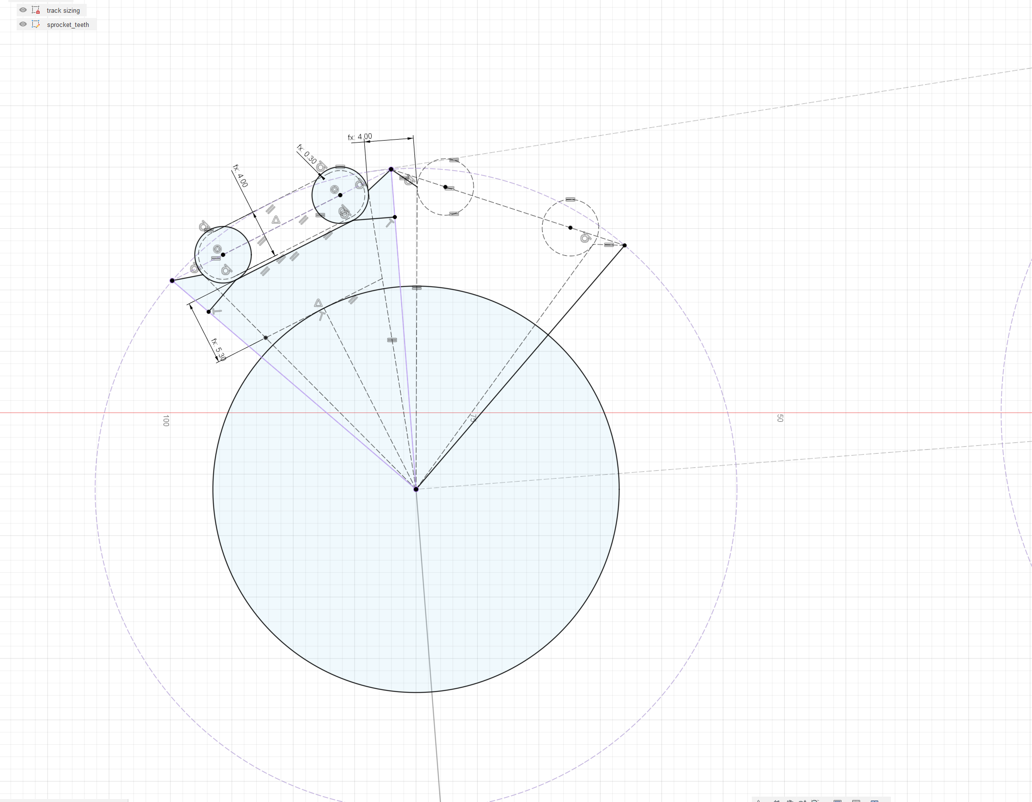

Step 3: The Tracks, Design

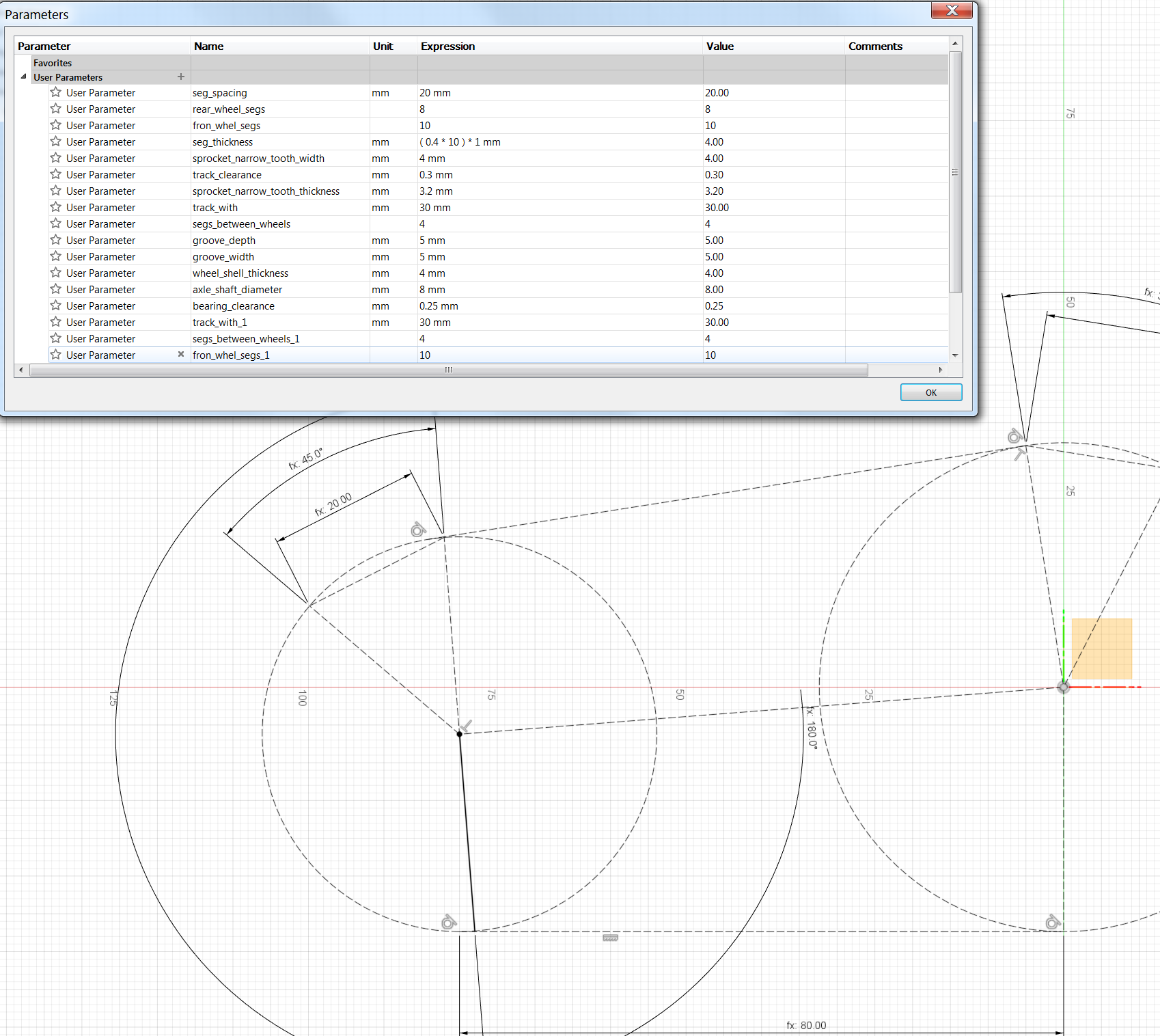

The design of a track is not trivial, and perhaps too much to go into in depth here, but it is also quite intuitive once you start playing with it, so I have provided a Fusion design in the project which demonstrates how I did it. I'll step through the basics of it here.
Core Parameters
As usual I begin by defining the core parameters. I have defined all of the variables that I will use to create a parametric sketch which defines a wheel that accepts a certain number of track segments of a certain size.
This will look complicated from this static image but if you open the file, navigate to the first two sketches and begin playing with the parameters it should make a fair amount of sense.
Since we know the length of a track segment and the number of segments in a wheel we can use that to drive the diameter of the wheel (the angle of each segment equals (360/num segments)). The images in the gallery are annotated with notes for more detail too.
Note the clearance between the teeth and the track in the wheel below.

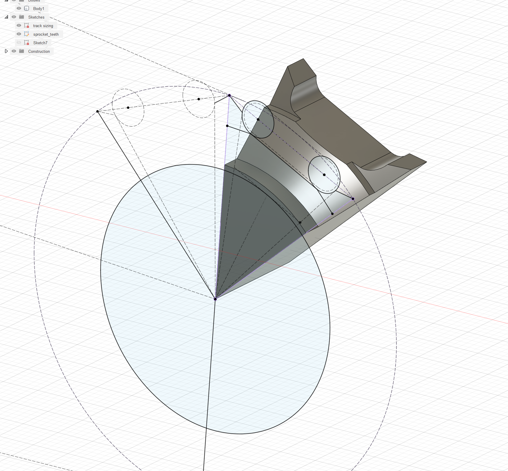

The profile is extruded here into a single segment of the wheel (and a revolved cut was used to make the groove down the middle).
A circular pattern (defined by the "Num Segments" parameter) creates the rest of the wheel, which can then be mirrored to complete it.

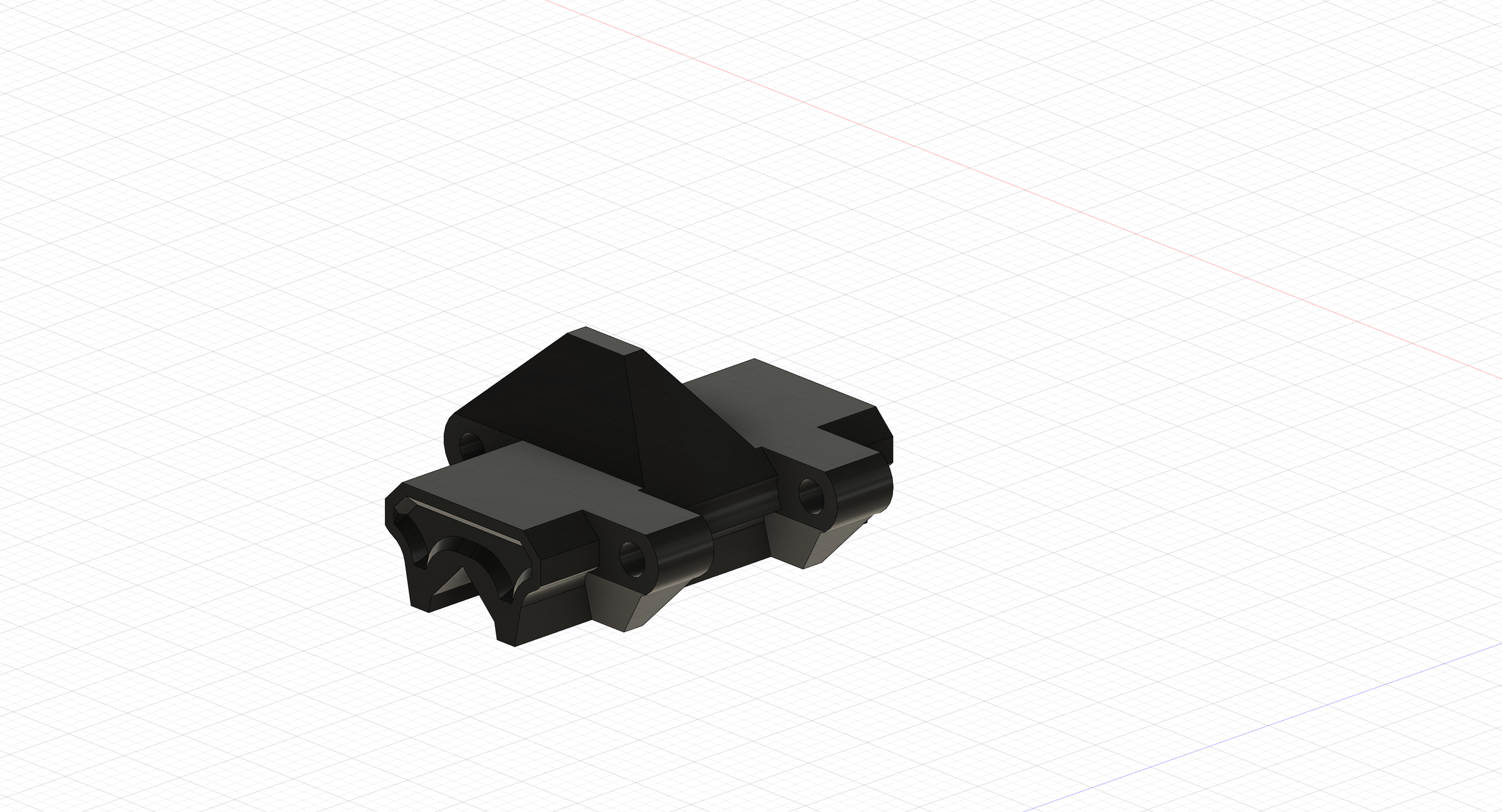

Printing Considerations
I knew well enough from my previous tracked builds that cleaning up track segments gets boring really fast, so I was adamant that I would avoid supports. Each track piece prints in the orientation shown below.
By sectioning the segment you can see that there are no overhangs greater than 45 degrees, so the print will be easily achived.

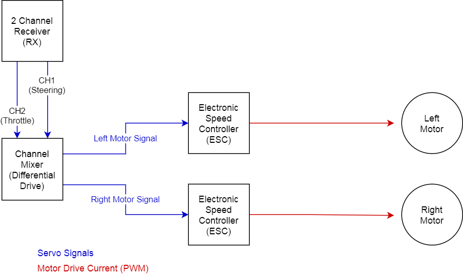

Traditional RC Tank Steering via Mixing
Steering an RC tank with two electronic motors is usually achieved with one Electronic Speed Controller (ESC) for each motor. The transmitter (or some receivers) handles the mixing of the channels so that the relative speed and direction of each motor can be used to drive and steer the tank.
Below is a simplified diagram which shows how the control signal from the transmitter is received, then remapped to a control signal for each motor.
This traditional solution has some benefits, such as zero-point turns where one track is moving forwards and the other backwards, but it also has some disadvantages, such as requiring two ESCs and a method of mixing the channels.
Simplified Electromechanical Steering
I didn't have two ESCs available during our Pandemic Lockdown and couldn't get more so I had to come up with a solution. It came to me that I could use one ESC to control the speed of both motors and simply use a servo to actuate a switch, cutting current to one motor, which would result in steering action.
The disadvantage to this is that our hardest turn will be one motor on and the other off, no zero-point turns. The advantage to this system is that it is cheap and easy to use. There is no mixing required so the most basic two channel transmitter will do.

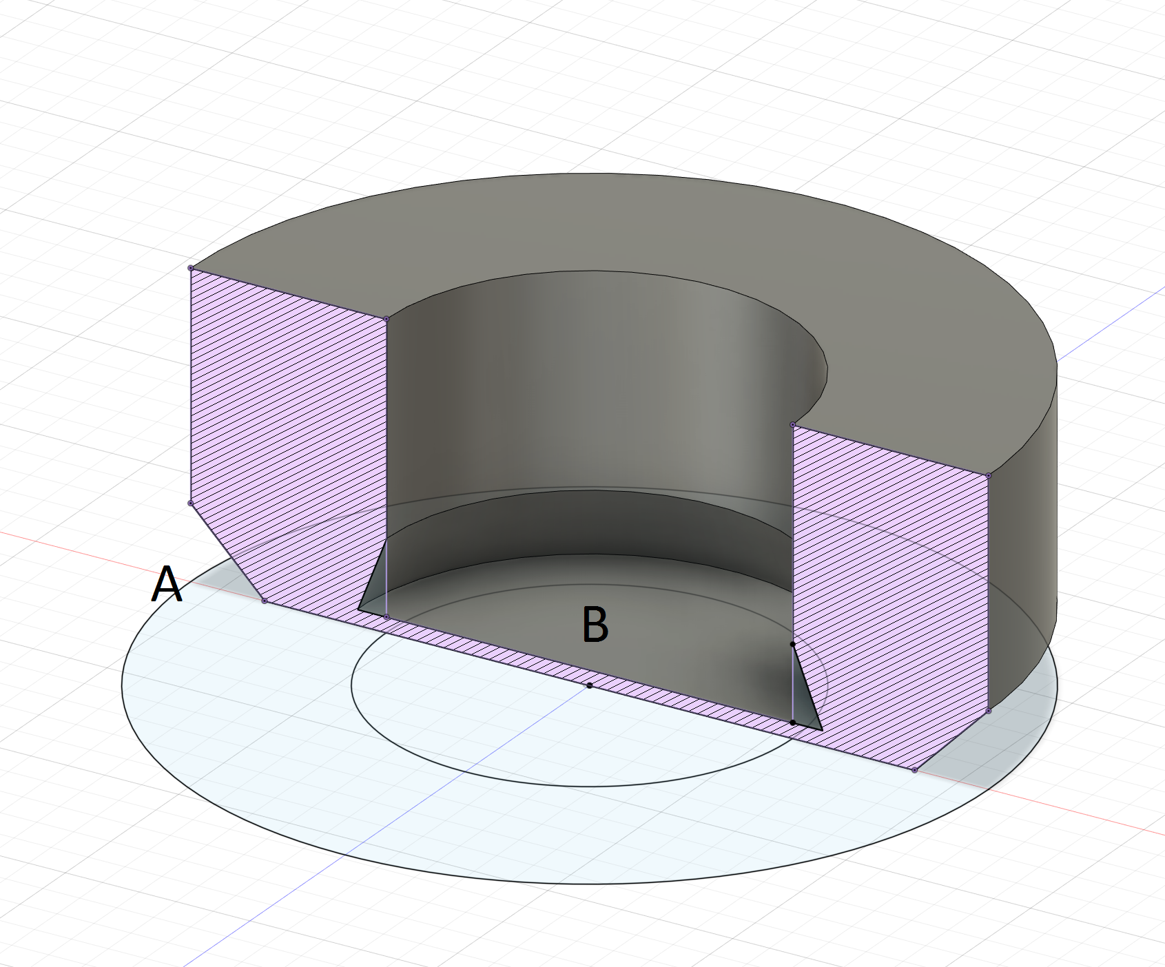

3D Printed Bushings, High(ish) Tech Solutions
Every one of the freewheels required two bearings. One of the options was to make a custom design for each wheel to use up all the odd-sized bearings that I had, but in the end I decided to print bushings which were the same size as the most common bearing that I had (11x5x4) and replace them with bearings after the Apocalypse is it was warranted.
There are a few little tricks to take notice of here since getting the perfect fit will improve their performance dramatically.
(A) I applied a chamfer to the bottom edge of the bushing so that the slight bulge (elephant's foot) that is common at the bottom of a print wouldn't affect the fit
(B) I create a 0.2mm thick face across the bottom hole, which greatly improves adhesion during printing, but is incredibly easy to remove since it is only one layer thick. Very helpful for such a tiny item.
(C) I made the outer dimension slightly smaller than the hole that it would fit into. A distance of 0.275mm worked nicely.

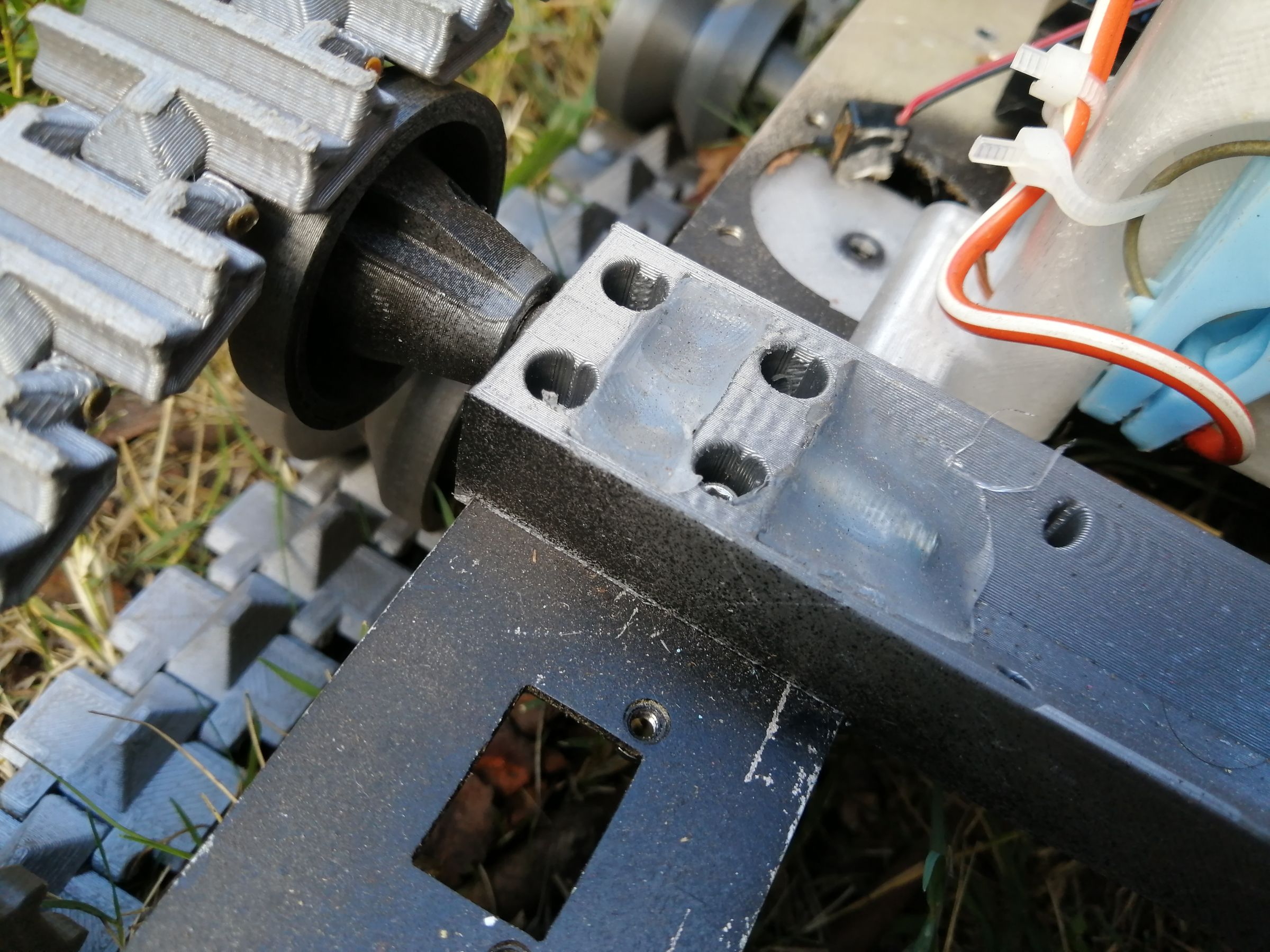

Glue in Place of Nuts, Just Plain Lazy Solutions
For the rear axle holder I tried to give myself as many options as possible, one of those was to leave a recess where I could squeeze in some hot glue to hold the screw in place, it turned out to be useful when I ran out of M5 nuts.
