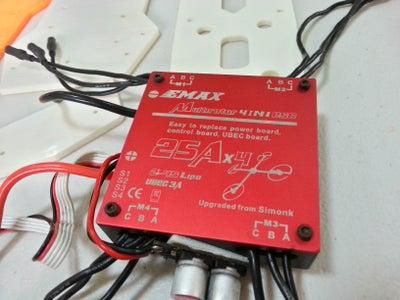

1x 4 in 1 ESC 25A / 4x ESC opto

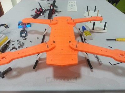

The slots you see encircled are the slots for your Arms you will need:
12x 3mmx20mm Screws
Insert all the screw first then lay it down on a flat surface, Attach the arms just like what I did on the 2nd picture
I used 2 screws since i'm out of stock.

ESC I chose the 25A ESC because it will give you that extra power you need when flipping You can also pick 4 in 1 ESC' because it will lessen the wiring problems.
http://www.banggood.com/Emax-Simonk-Series-12A-20A...
http://www.banggood.com/Emax-Quattro-25A-X4-UBEC-M...
