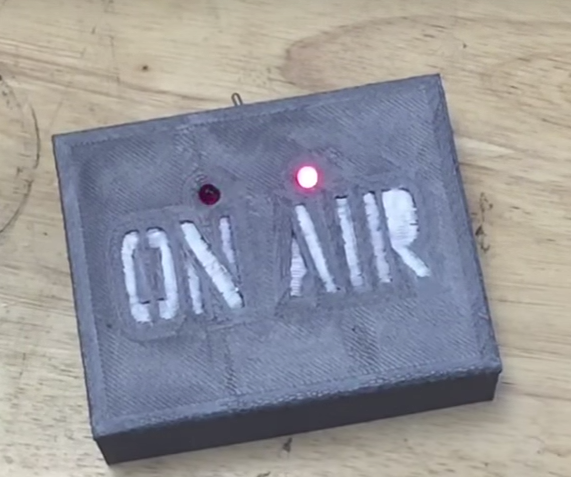

Step 12: Success
You just created a handy tool for your electronics workbench. You can use this to test polarity of diodes as well if you set the meter to diode mode. You can connect power through a resistor to the connectors to make this an LED tester. It's a very handy print.
