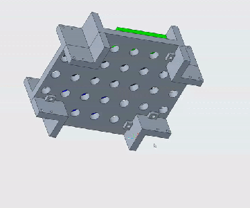

Step 2: Main Frame Design
To begin the assembly process, start with the main frame and the attachment of the legs. Once the main frame (main_frame) is printed, secure the frame_leg_links in the manner shown in the provided GIF file. Use M3 screws to attach each leg to the frame.Frame cover will come on top of the main frame. This will hold the Raspberry Pi fixture.
The frame design is adjustable and looks like cheese to keep things modular, help with cable organization, and make it easy to tie down components with zip ties.
I also made a test stand if you want to change the code and test things out safely.
