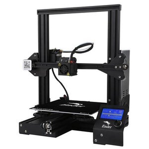

All parts have been designed in Fusion 360 to be easily printable with an entry-level 3d printer (Creality Ender 3). After countless iterations, I am pretty happy with the result: for under $100 YouMakeRobots provides an entry level robotics kit that allows people to design & build their own robots!

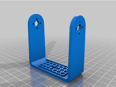

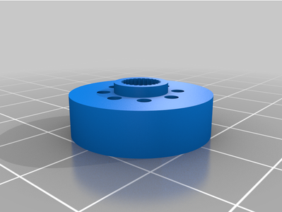

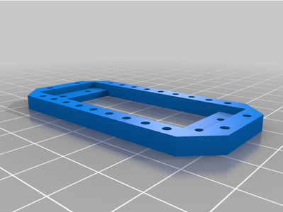

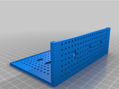

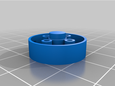

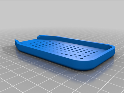

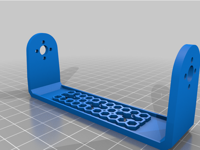

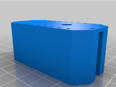

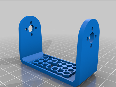

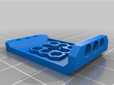

Step 1: Download YouMakeRobots 3D Printed Parts
Step 2: Download YouMakeRobots Source Code on Github
Step 3: Print Your Parts
3D Printed Parts (for the 2 example robots biped+quadruped)
  • F1 (x4)
  • F2 (x4)
  • F3 (x8)
  • F4 (x4)
  • F6 (x4)
  • Servo_Enclosure_Bottom (x8)
  • Servo_Enclosure_Top (x8)
  • Servo_Horn (x8)
  • Servo_Pin (x8)
  • F51 (x2)
YouMakeRobots 3D printed parts are easy to print and print support free. In order to speed up the process, you can dispose multiple parts on the build plate.
The main difficulty with these parts is to get a good adhesion of the first layer. Do not hesitate to slow down the print speed to 10 mm/s or even 5 mm/s for the first layer if needed.

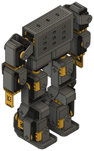

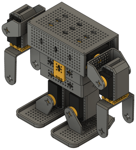

Step 4: Assembly
You can design & build your own robot or build one of the 2 example robots.
The first robot is a quadruped robot actuated by 8 servo motors. The second robot (Zombie) is a biped walking robot. Both of them come with complete video assembly instructions + basic code to walk.
Follow the video instructions to assemble your first robot!

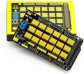

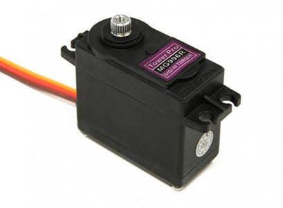

The servos are controlled by an Arduino MEGA board. In order to easily connect the servos to the Arduino MEGA, I use the MEGA Sensor Shield V1 from Keyestudio. The Sensor shield simply plugs on top of the Arduino MEGA board.

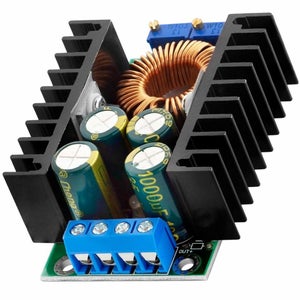

The power is provided by a 3S, 11.1 Volts polymer battery. As the Arduino and the servos require only 5 Volts, I use a XL4016 DC-DC converter to reduce the battery voltage.
XL4016 DC DC converter connection
  • Battery red wire to IN+
  • Battery black wire to IN-
  • OUT+ to VCC of the Keyestudio MEGA sensor shield
  • OUT- to the GND of the Keyestudio MEGA sensor shield
Adjust the output voltage of the XL4016 to 5 volts
Connect a multimeter between XL4016 OUT+ and XL4016 OUT-. Set the Multimeter to 20 V===. Turn the blue potentiometers on the XL4016 step down converter until the output tension reads 5 Volts on the multimeter. There are normally 2 potentiometers : one coarse and one fine.
After adjusting the output voltage of the DC DC converter to 5 Volts, you can connect the converter to the Arduino MEGA.
Servo connection
The servos are connected to the sensor shield, using pins 22 to 45. Connecting the servos to the MEGA before assembly ensures the servos are correctly centered.
Servo connection for the Quadruped robot (top view)
=(7)=(3)|  |(0)=(4)=
=(6)=(2)|  |(1)=(5)=
  • Servo 0 = Front Right (pin 22)
  • Servo 1 = Rear Right (pin 23)
  • Servo 2 = Rear Left (pin 24)
  • Servo 3 = Front Left (pin 25)
  • Servo 4 = Front Right Leg (pin 26)
  • Servo 5 = Front Right Leg (pin 27)
  • Servo 6 = Front Right Leg (pin 28)
  • Servo 7 = Front Right Leg (pin 29)
Servo connection for the Biped robot (front view)
=(1)=(0)=====(4)=(5)=
       (2) (6)
     (3) (7)
  • Servo 0 = Right Shoulder (pin 22)
  • Servo 1 = Right Arm (pin 23)
  • Servo 2 = Right Leg (pin 24)
  • Servo 3 = Right Foot (pin 25)
  • Servo 4 = Left Shoulder (pin 26)
  • Servo 5 = Left Arm (pin 27)
  • Servo 6 = Left Leg (pin 28)
  • Servo 7 = Left Foot (pin 29)
