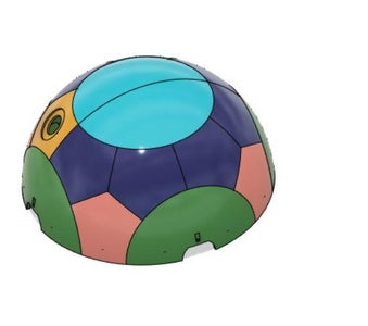

Step 6: PRINTING and Gluing!!! PART 1- Upper Hemisphere
To print the upper hemisphere you will need.
(all files can be found in the "BB8 outer body" folder)
Main pieces
please follow the photos for where each piece is supposed to go
7x Regular pentagon connector- DARK BLUE
4x Middle Pentagons-PINK
4x Middle top half circle-LIGHT BLUE
1x Hole for button- Pentagon- YELLOW
All of the main pieces were printed with these settings:
.28mm layer height
3 perimeters
10% infill
with raft for stability and to protect against elephants foot
Connectors
13x Disc connector (In the "body connectors" folder inside the "BB8 outer body" folder)- BLACK
8x Half disc connectors (Also in the "body connections" folder)- ALSO BLACK
All connectors were printed with these settings:
.15mm layer height (to get the best curvature on the discs)
2 perimeters
20% infill
CONNECTING THE PIECES
Once you have all the pieces printed out for the upper hemisphere you first need to do a bit of cleanup, sand away any of the leftover supports inside any of the holes for the connectors, it will make your life a lot easier going forward.
Now, all of the pieces get glue end to end in the configurations in the photos shown above.
It will be easiest if you follow this order:
Glue the two LIGHT BLUE half rounds together making the top circle. Using one full disc connector (BLACK) in the center like the real life photo of mine above. Then glue four more round disc connectors (BLACK) on the remaining holes of the circle. Then glue up 3 pentagons together, 2 regular pentagons (DARK BLUE) and one middle pentagon (PINK) to create the weird "tri corner shape"
IMPORTANT!!! when you glue the 3 pentagon piece to the LIGHT BLUE circle the middle pentagon (PINK) MUST be sticking up!!! there is a hole on the bottom of the "Middle pentagons" and that must be pointing towards the middle, so PLEASE do not get them mixed up!!
Now make 2 more of the "tri cornered pieces" by gluing up another 2 regular pentagons(DARK BLUE) and one "middle pentagon" (PINK) and glue them to the circle made up of LIGHT BLUE pieces. Just like in the photo shown above. Using the full disc connectors (BLACK) and half disc connectors (BLACK) when necessary.
For the last "tri corner piece you must use: 1 regular pentagon (DARK BLUE), 1 hole for button pentagon(YELLOW), and one middle pentagon (PINK) and once again, the middle pentagon (PINK) MUST MUST MUST be pointing up as shown in the photos above.
LASTLY glue in the remaining four "Middle top half circle" (GREEN) in the empty places to complete the top hemisphere!!! Don't forget to add the half circle connectors(BLACK) in the empty sockets near the rim.
The holes in the pink pieces point9ng upwards is extremely important for the connection of the hemispheres, eventually there will be alignment pins there and you don't want to try and build this without it.

You'll need these files: (bb8 head -> outer shell-> main shell. folder)
1) 7x head thin
2) 1x head thin holes for light (really weird name, I know)
3) 1x head cap part 1
The head is really straight forward all of the thin pieces (besides the cap) get glued end to end creating a dome. then you glue the cap over all of those (see the photo above).
All of these get glued end to end with no friction welding. glue was enough for me here, I just tried to squeeze as much as possible on the inside and the outside of the seams.
