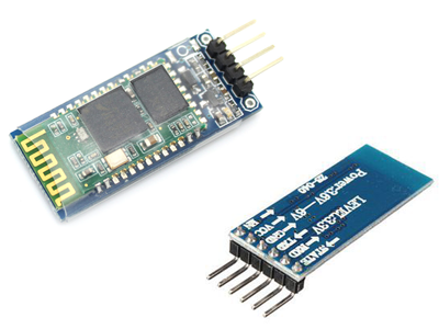

Step 4: Bluetooth
After we finished assembling the spider, we connected all 12 Servo motors to the central Arduino Nano using the Nano 328P Expansion Adapter Breakout Board IO Shield.
We connected the HC05 Bluetooth Module to the breakout board (TX --> RX, RX --> TX). Using an open source "Bluetooth Car Controller" (https://play.google.com/store/apps/de...) app on the play store, we connected an android phone to the Arduino Nano.
