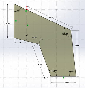

- Using SolidWorks (or another 3D modeling software) start drawing the basic shape of your fin

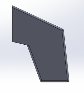

- Extrude the fin to your desired thickness. Mine was between 2 and 3 millimeters wide.
- Fillet, round, and taper edges to desired shape. This will affect drag. I decided to round my edges on the leading edge so that they would be more aerodynamic, reducing the amount of drag on the fins.
- Make sure that the fin model is fully defined so that you know that it will work with the full rocket assembly model.
In my first design, shown as the first picture, I had not researched as much as I should have before starting. I jumped into graphically modeling the fin, and made a design that looked cool. After mathematically modeling the first fin, I realized that I could have made a more efficient design, so I came back and ended up with the fin on the right.
The difference between the fins is that the second design has a bit more surface area that is farther away from the body of the rocket. This serves two purposes; it keeps the fin away from the engine to prevent it from burning, and it makes the rocket more stable. Also, the placement of the fin on the body is in such a way that more of the fin is lower to the ground. This brings the center of mass and center of pressure towards the bottom of the rocket, which is desirable.

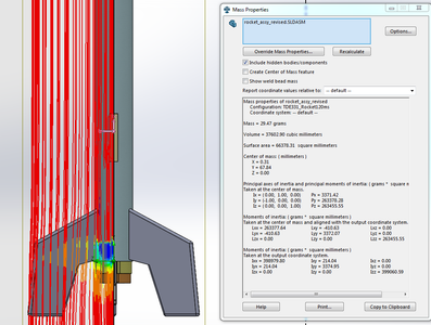

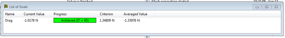

As pictured, I ran a flow diagram on my model in SolidWorks. This shows me where there are areas of high and low pressure, representing the drag on the body and fins. While not necessary, this helps you refine your design and minimize drag to achieve the best results.
I also used SolidWorks to evaluate the center of mass, center of pressure, and drag coefficient (see pictures). These values all show me if this design is going to provide a usable rocket fin.

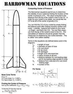

You can also use the Barrowman Equations sheet, formulated in excel to check your location for center of pressure. This gives you a pretty good estimate to the location of the center of pressure on the body. It is ideal to keep your center of pressure between one and two times of the rocket diameter below your center of mass. This ensures the greatest stability during flight.

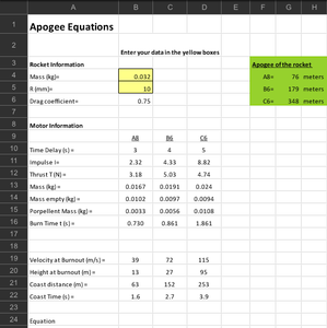

The other page on this excel file show the apogee equations. My predicted altitude is 76 meters or 249 feet.
This step involves a lot of back and forth work with the graphical modeling step. You will take measurements to calculate the CoP and then modify the design to achieve better results. Do this until you are pleased with the estimated CoP.
