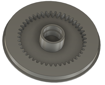

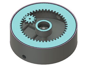

first of all measure your motor and ball Bering I attached the fusion 360 cad file so you can change the design base of your motor size
Step 2:
making 3d design for our project, you can download my design
Step 3:
Print all three parts and assemble together , if you using 0.8mm nozzle I think it take about 18h to complete.
