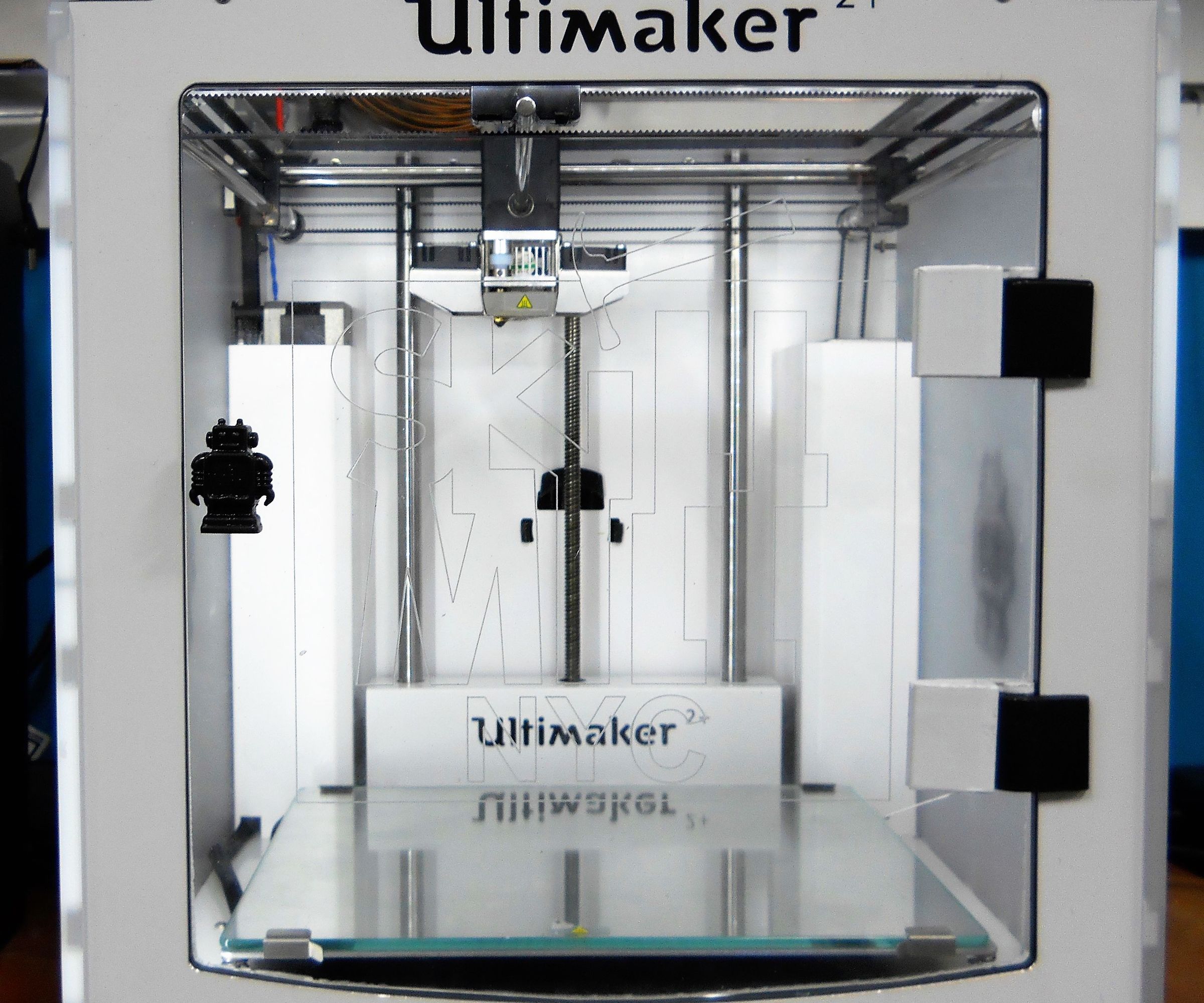

First thing you will need to do is print all the parts. I printed mine on a Makerbot Replicator 2 with a layer height of 0.2 mm with no supports for any of the parts. All the parts can be downloaded below.
