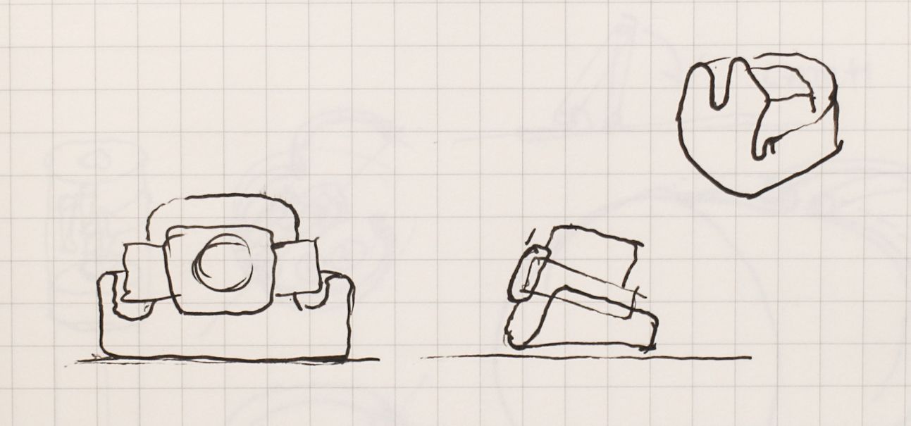

The design is simple. Before I got started, I quickly sketched an idea of the shape of the dock. The Apple Watch becomes an alarm clock when it's charging and oriented on its side, so I designed the dock to be kind of a cowboy hat shape- there's a bubble in the middle that holds the charging pad with a raised brim around it to keep the watch band in place.

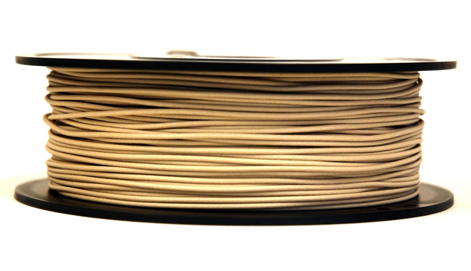

I used MG Chemicals Wood 3D Printer Filament for the cradle because I love the quality of the finish. It feels just a bit classier than PLA plastic and behaves very well on my printer. It responds well to sanding and wood stains, and it actually smells like wood while it's printing!

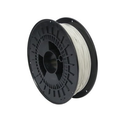

For the flexible insert part, I used Matter Hackers White Soft PLA. It's flexible, but not elastic. This means it keeps its shape but won't break when you force it into a tight space, and will allow you to push it into the cavity at a weird angle.

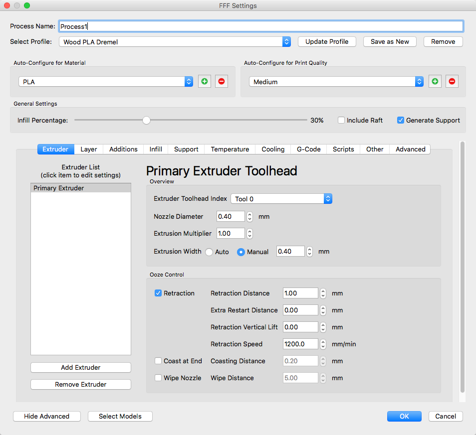

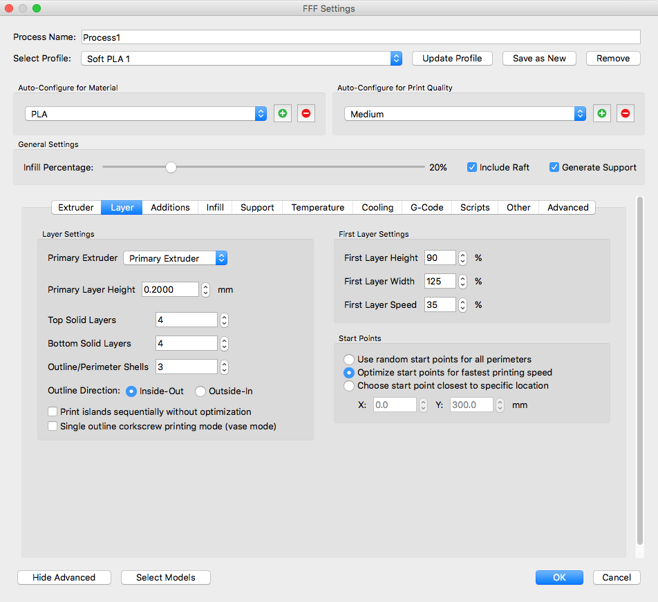

SETTINGS
I use Simplify 3D for all my slicing because it gives me a high level of control, has excellent support structures, and yields good results just about every time.
Wood Filament Settings
Soft PLA Settings: Do no preheat nozzle!
