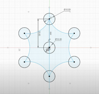

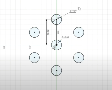

Step 1: Sketch With Fusion360

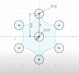

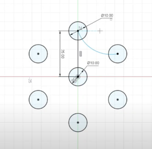

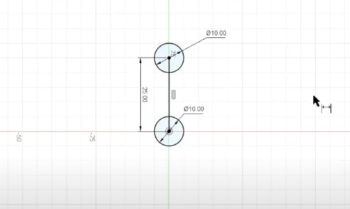

1> start sketch on ant YZ plane.
2> draw the circle of 10mm for the center.
3> draw a centerline of 35 mm from the center of the first circle.
4> Draw another corcle on another end of the line with a 10mm diameter.
5> select the circular pattern command and select the 2nd circle for the pattern.
6> select center circle for rotating axis.
7>select 6 numbers of pattern quantity.
8> connect the nearest circle by using the arc command and use a circular pattern for the same.

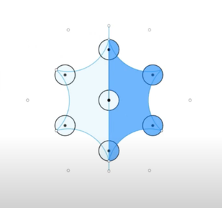

9> make a center verticle line to make two halves for the sketch.

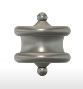

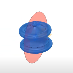

Step 2: Revolve Sketch Profile
Use revolve command and select half of the sketch and select the center axis for revolve sketch.

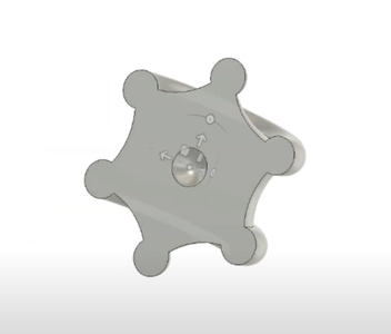

Step 3: Cut Through and Rotate Body

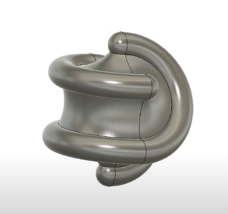

After revolving the sketch profile you see objects like 1st images.
To make it half, we use the split body command to make 2 equal halves for 3d printing.
After making 2 separate bodies, select any of body and rotate them at 60 degrees (360/6 side).
Step 4: Export Design
Export bodies into.STL files for 3d printing.
print this .stl file two times to complete the object.

Step 6: Connect 3dprinted Parts
I use Superglue for joining both parts.
Rotate any part at 60 degrees to make a spheroid. (check the images attached)
Note: while joining please check the direction of joining 2 parts is the same as rotation does in Design(60 degrees).
