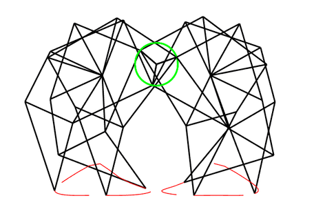

This project was inspired by Theo Jansen's walking Strandbeest robot model, a wind-powered automaton that uses precise joint lengths and complex angle relations to mimic a leg walking motion powered by a single rotating joint. As shown in the attached GIF, the base component is relatively simple, the rotating axis moving every part of the leg at such an angle that the "foot" drags on the ground a set distance, then lifts itself up and plants again at a further distance. Theo Jansen, the inventor of this 2D walking mechanism, labelled this set of line ratios the Jansen Linkage, and the multicolored image attached shows the newest iteration of the leg ratio numbers which I followed and converted to a real-scale centimeter model. The singular leg model is relatively simple and straightforward, and the project attains its complexity through the combination of multiple of these legs, as at least eight joints are required to make the robot move properly, each leg being slightly offset to ensure stability in motion. This project is my attempt at mimicking this design using 3D printed PLA plastic parts, an unreasonable amount of nuts and bolts, Fusion 360 for modelling and the Creality K1 Max 3D printer for the printing.

The first detail to keep in mind during this step is that the two legs being joined together must be mirror images of one another, flipped over a vertical axis. Referring to the red/yellow joint images above, it is important to remember that the pieces connecting the lower triangle to the upper triangle will be kept rigid in the final design, and should not be glued together, rather connected to the main body in the next step. On the other hand, the black/yellow protruding joint is the piece that connects to the other leg, and then to the main body, and is the part that revolves in a circle to complete the projected movement.

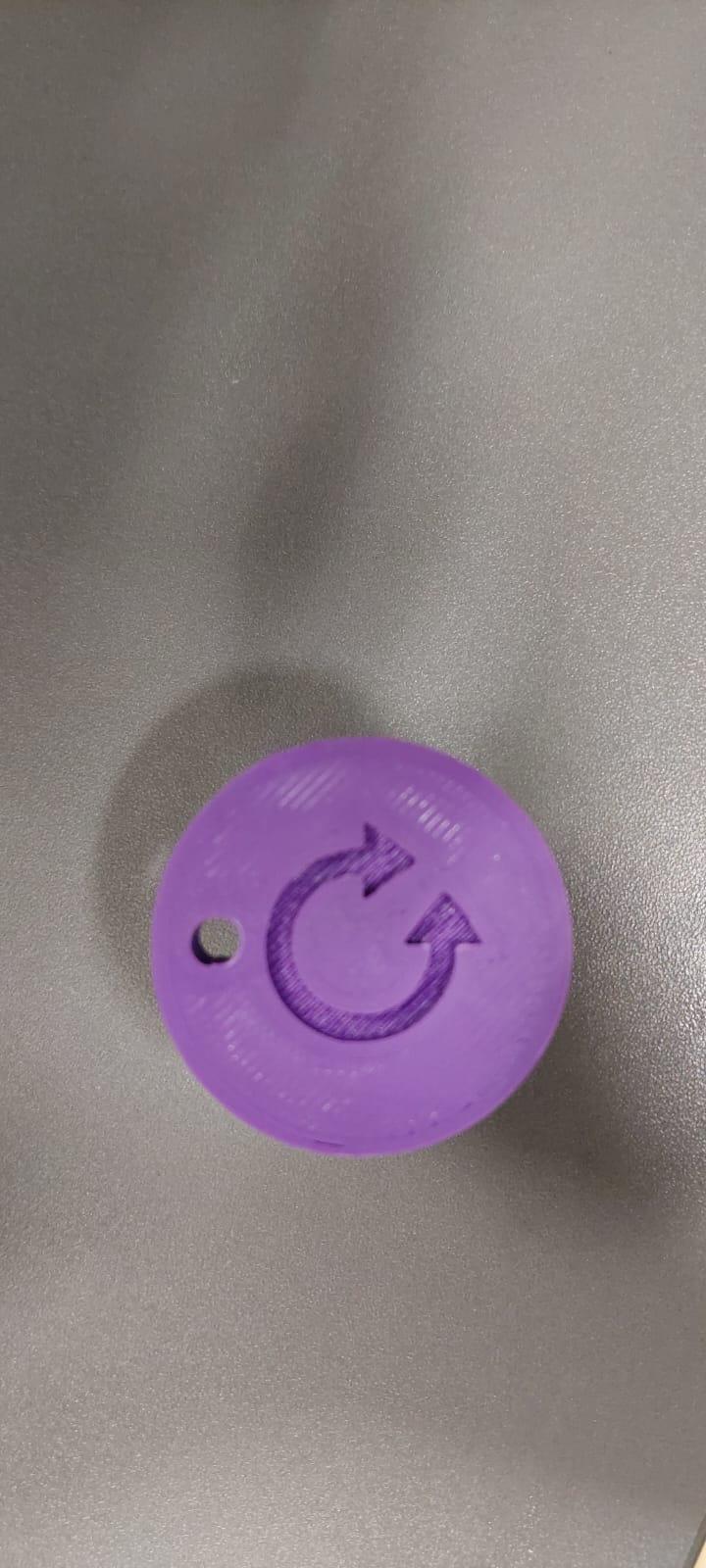

The first step is to connect the axle and legs to the body. As shown in the image above, take one side of the axle and push the part through the gear connector. The gear connector is the piece with the arrow decorations on it, and is the piece that rotates when powered. Make sure to push the axle joint all the way until the legs touch the gear connector, then using the miniature 3D printed clamps provided, secure the axle in place so that it cannot fall back out of the joint. If the robot were to be turned on at this point, the axle would begin moving the legs in a circular motion, but the axle itself would be fixed in one position. This is not the correct movement yet. To achieve the proper motion we must ground the center of the axle in the center of the body, and have the center remain in one place while the offset arms rotate in circles around the main piece. This will be done with the two-part joint connection tool shown in the images above, the piece with long rectangular holes that is split down its center.
